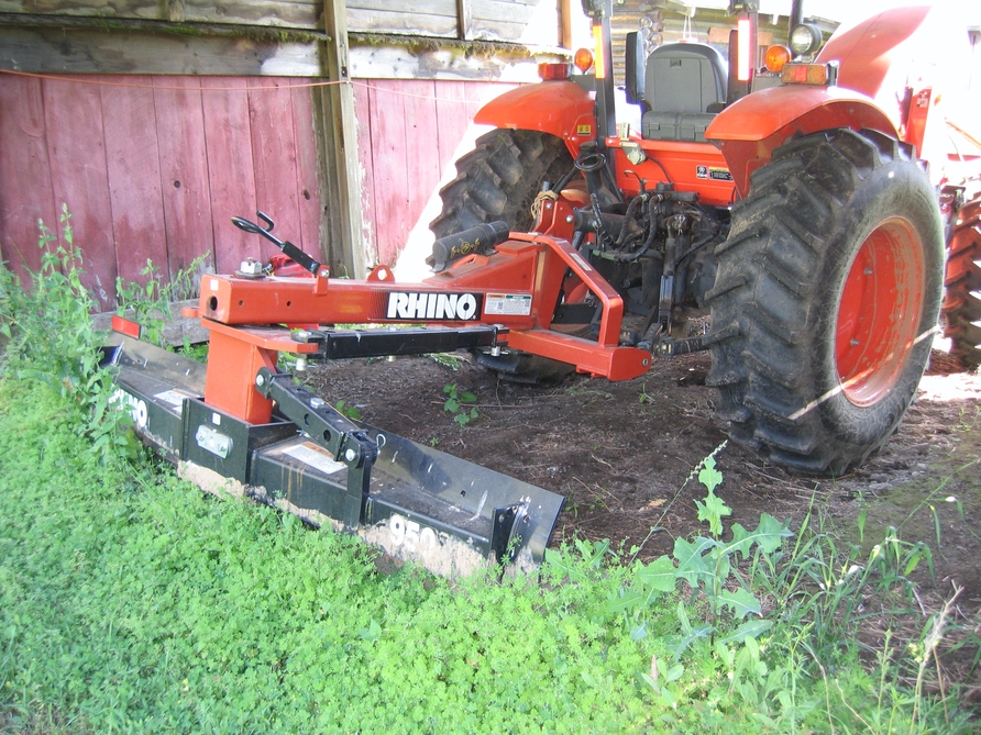

I have a Rhino 950. Eight feet wide - 1050 pounds. I got really tired of those lighter rear blade that just "clink" along my mile long gravel driveway and make sparks.

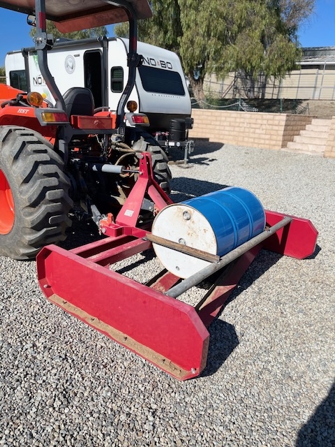

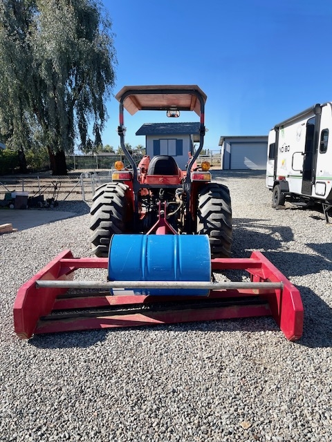

I have an 8 footer. It weighs 500 pounds but that was not enough for scraping weeds off of hard dried clay soil so I added a 55 gallon drum with the potential for another 500 pounds. Now she's heavy enough plus I can add or delete weight by adjusting the water level. (y)
