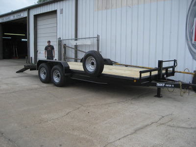

I have found a 20 foot bumper pull car hauler with 2 foot drop down, wooden deck, dual 6K axles, 10 ply tires with a spare, electric brakes on back axle with break away battery back up and heavy duty 6000 # front tongue jack for $2995. I dont think I can beat that price for the size trailer. It doesnt appear to be a name brand so likely locally shop made. I will have to call back and find out who made it and some more details, but I'm pretty sure I am going to buy it.

Considering the load capacity of the trailer, my concern would be that it only has brakes on one axle. Otherwise that looks like a well-made trailer for a good price. If you buy it, I'd recommend adding brakes to the other axle.

Yep, add them brakes to the second axle asap or you will be replacing truck rotors as soon as you get it. Been there done that.

Since the dealer doesnt have one in stock but has one ordered, I might be able to get them to put on 2nd set of brakes at the fab shop. I will check on that and the price to have it made that way.
   / Heavy hauler: Can this price be beat?
I went to ABCTrailer parts checking price difference in axles with brakes vs without brakes and was surprised at the low cost difference. $110 per axle for 3500#, $145 each for 5200# and $170 each for 6000#. For such little cost to add, why is it that trailer suppliers dont put them on to make their trailers safer. Seems that for $220 added to the cost, they could sell their trailer as safer for just a few dollars more in cost. Since they buy in bulk, the probably dont pay that much for them either and this was premium drum type electric brakes not the trailer house axle type cheap stuff.

I looked at a Kaufman 20 foot car hauler with 10400# rating and it had the little light weight tongue jack($25 at TSC) like my boat trailer except no wheel. Everything else looked well made. The heavy jack is optional along with spare tire
I just got info back from the dealer, they are going to have manufacturer put brakes on front axles so I will have 4 wheel brakes for the hefty price of
$150 extra. Why would someone not do this for that price. It was $250 if they did it there. Maybe that answers my question on why dealers order them with just rear brakes, make a little money for their shop folks.
Total out the door price including $5 temp tag $3150 for 20 foot wood deck with dove tail, sto-away ramps in the rear, 12,000 GVW, 10 ply rated trailer tires with spare tire and spare tire mounting bracket, 2 5/16 bulldog hitch, heavy duty drop down tongue jack with estension to side of trailer for winding handle, extra heavy gauge fenders and delivered to my daughters house for me.
