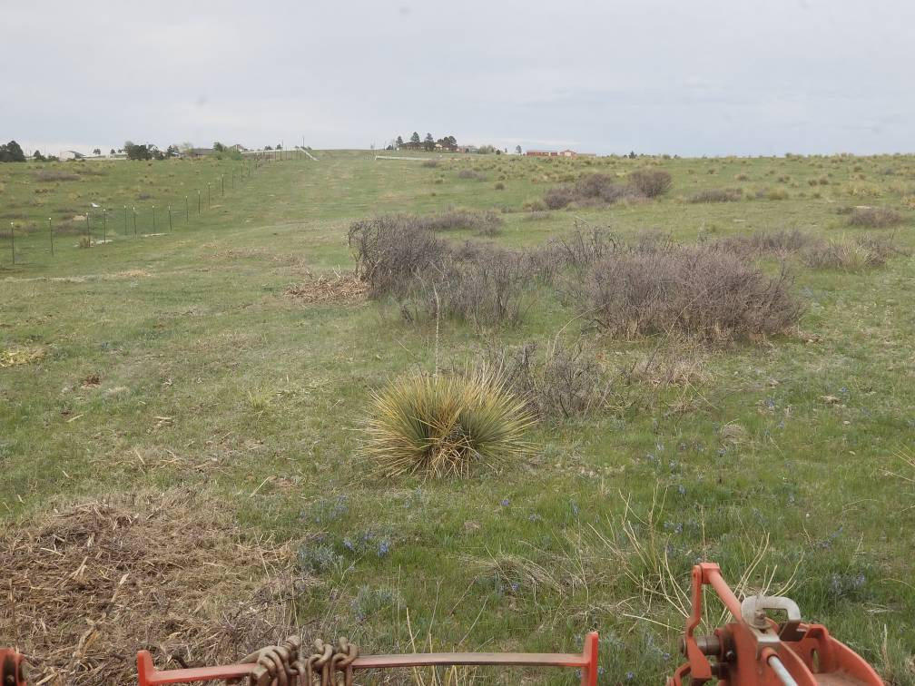

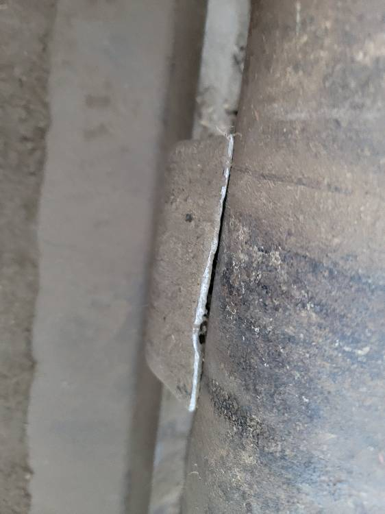

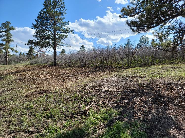

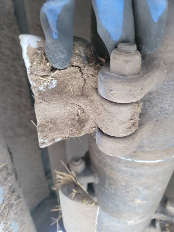

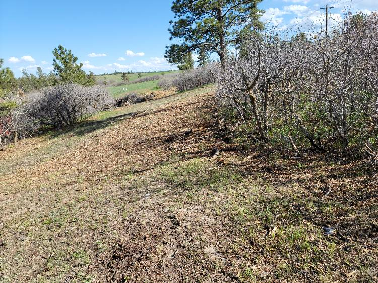

Peruzzo Brush Bull. The 40hp L4060 is pushed lifting it & is completely tapped out mowing yucca, scrub oak & small Christmas trees. The mower eats wrist sized sticks & makes a lot of noise but handles em fine. I found rocks, cinder blocks & a 20lbs starter motor with the flail. A couple minor chipped teeth but nothing close to me considering putting on my spare hammers yet.
1,700lbs & $8k or so but holds up to the light commercial work I do. Nice knowing the worst case scenario isn't breaking my equipment but having to untangle wire working in rough or trashy fields.

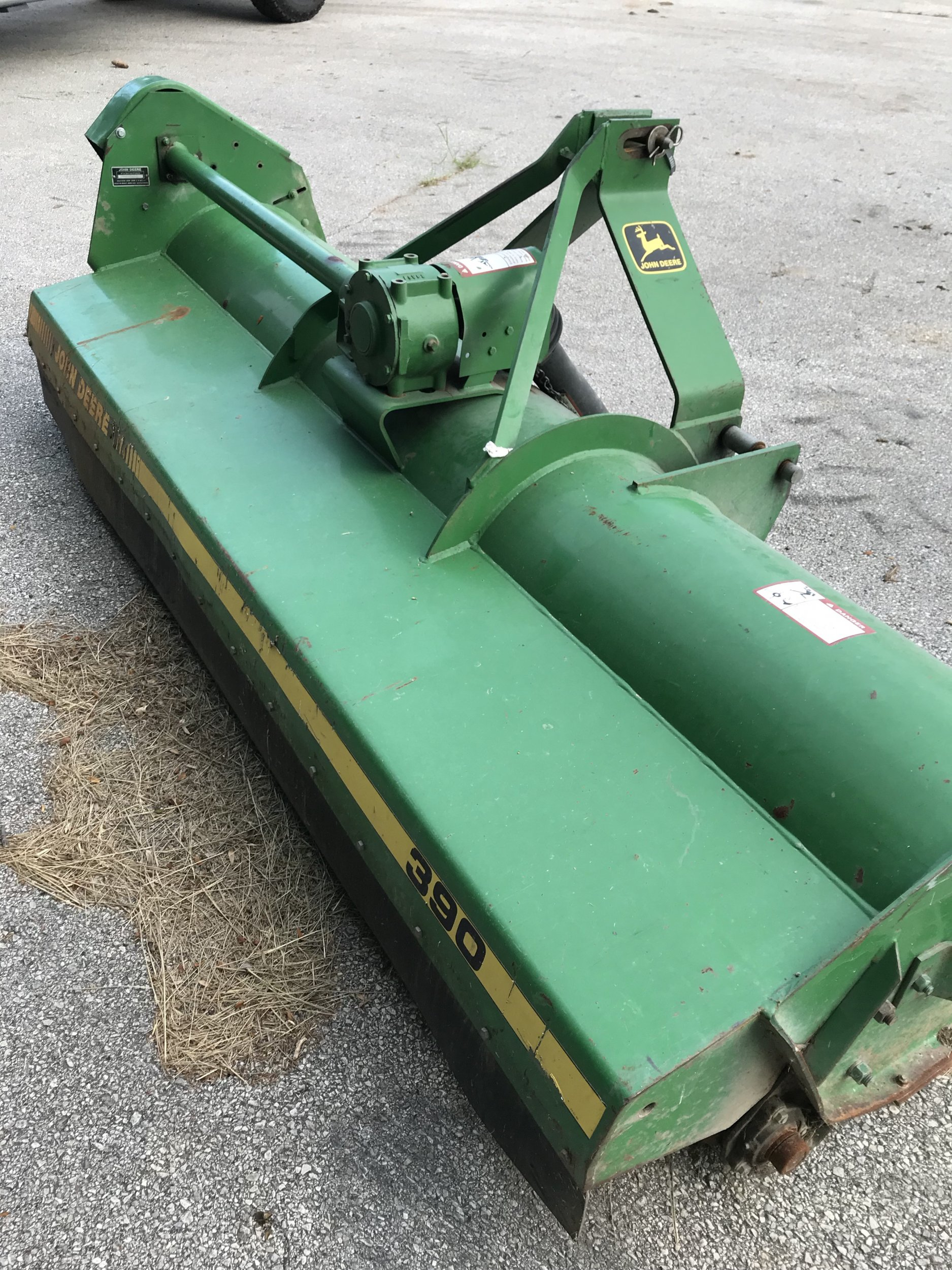

John Deere 390 flail mowers are pretty stout. At 90” wide, they have good cut size and they are available with offset. I have one, don’t use it much anymore because I have gone bigger.
