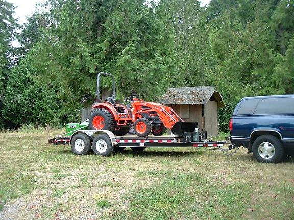

So the new BX24 was delivered yesterday! I asked for a post hole digger with a 9 inch auger and a 48inch box scraper as well. I didn't get any more specific than that on the implements as I am a total newbie in this department. What arrived was a Rankin RBS48 box scraper (in Deere green /forums/images/graemlins/mad.gif) and a Rankin 601 post hole digger. Both of these devices seem extremely rugged. My concern is that they may be too rugged. The box scraper is 405 lbs. Scraper The BX24 manual says the max weight for a box blade is 375 lbs. Should I be concerned about that?
The digger is a Rankin PHD601, Digger, which says it is for tractors with 25-65 HP. The BX24 is only 23 Horse. This digger looks like it would cut through asphalt. Is this a little too much for my little tractor?

Congrats on the new machine! With 540 hrs in 14 months (BX23), I can assure you it will continue to amaze you with it's capability each hour.
My box scraper is 430# and works very well. I don't know what to think about some of Kubota's implement limitation recommendations and, so far I haven't found a reason to care /forums/images/graemlins/wink.gif
I don't have a real answer about the PHD but from the specs, it uses the same size output shaft and shear bolt size as the smaller models (and other brands) use. I wouldn't hesitate to use it.

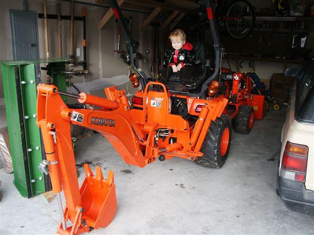

I also own a green rankin and an orange(another orange) tractor. You'll get used to it. I've been told the rankin box is actually a woods product. It is very stout and weight is your friend on a box blade.
My question is how do you intend to set it on its bottom to hook up. 500 lbs will fall with a mighty thud.

Lets see, does he use the loader, or maybe the backhoe for that job? One more reason to own these machines, they can pick up their own toys!
