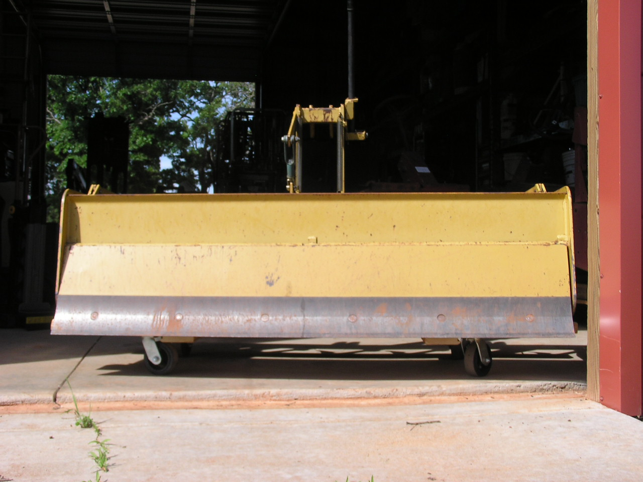

And with a high back, floating tailboard, manual lever lifted ripper shanks, my favorite:

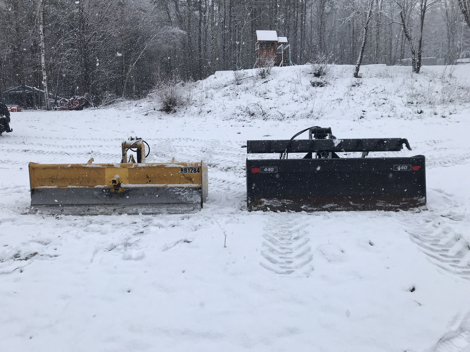

For box blades, I can personally recommend (in order of “least heavy duty” to “most heavy duty” the Landpride 35 series (1000lbs), the frontier BB1284 -1250lbs (rebadged Gannon), and the even more heavy duty Paladin/FFC 440 (1550lbs)
These all have hydraulic scarifiers and are all cat 2 compatible.
Be careful of the so called “severe extreme” duty ratings. The one linked above weighs only 720 pounds, vs the truly heavy duty ones which are considerably heavier. Of course, that may be all you need, but just be aware.
