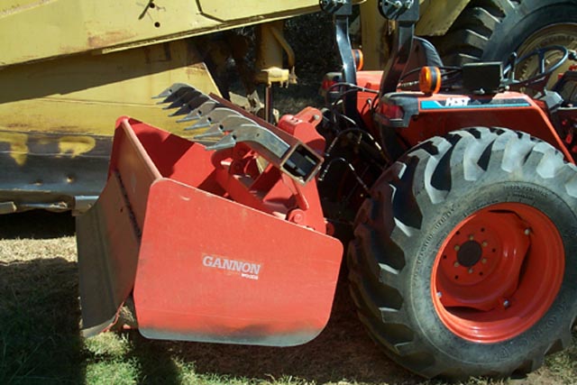

Here is a picture of a Woods/Gannon HD4272HB Scraper with hydraulic rippers. The hydraulic controls are mounted to the fender. I have had very good luck with it, but it is overkill for most compact tractor applications. This model has both cat1 and Cat 2 3PH pins.
HD - Heavy Duty
42- means 4x2 (what ever that means)
72- 72" wide
HB - High Back
It weighs about 1100lb.
Good luck, Hope this helps.
