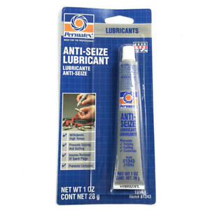

IF you can get it hot enough you can not touch it, its going to be hot enough to release, you only need to raise temp a few hundred degrees, and I would bet you can not get it hot enough with propane torch or acetylene (Prest-o-lite) torch to melt it unless you have along time to apply heat....
If you have welder, put big nut on it and burn it on then remove plug/nut while still hot....
Anti seize Lubricant is your friend....
