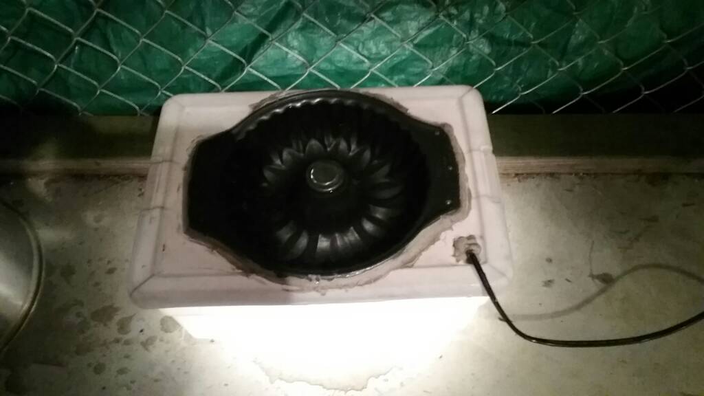

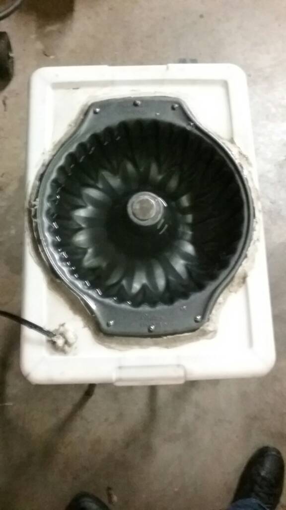

Over the years I bought several heated pet water bowls. They use a lot of current, they're expensive and don't last. I decided to make my own a couple years ago. After a few trials, this works perfectly.
You need a Sterilite box (plastic box from dollar store, about 8"x 14", 6"ht.
Bundt cake pan (large, dollar store or Wal-Mart)
Ceramic light socket
A.C. cord, caulk, bungee cord, light bulb

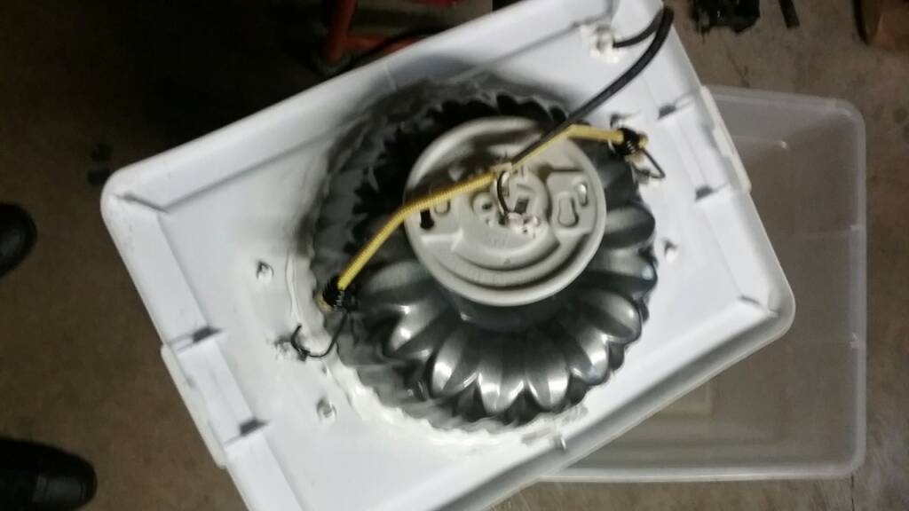

The light bulb/socket goes up inside pan.
Socket held in with bungee cord.
Box top cut for pan, caulk in place. Small hole in top for cord. Snap top on box.
That's all there is to it...except fill with water. I used a 28W (40watt equivalent) halogen bulb...most any incandescent bulb works just so it gets warm.
Advantage is it doesn't go bad or give trouble. Bulbs are cheap if it burns out. And it serves as a night light.

I had a few of those too. They either cracked or the heating element opened up.
They use 60 instead of 28 watts.
since theirs have a built in thermostat, that 60 W potential draw gets used less often than your design, which draws 28W 24/7, and could make the water too hot to safely drink!. also, in cold enough weather, it may freeze up from not enough heating, with that 28W heat source!.. things are designed a certain way for good reasons!..
   / Heated pet water dish...the best!!!!!
I'm trying to help. It works well for me. Water too hot? Use a lower wattage bulb.
Want a thermostat? They're available too, and not expensive.
Yes, things are designed the way they are for a very good reason...planned obsolescence. Made to break.
It's a free country...use what you want.
