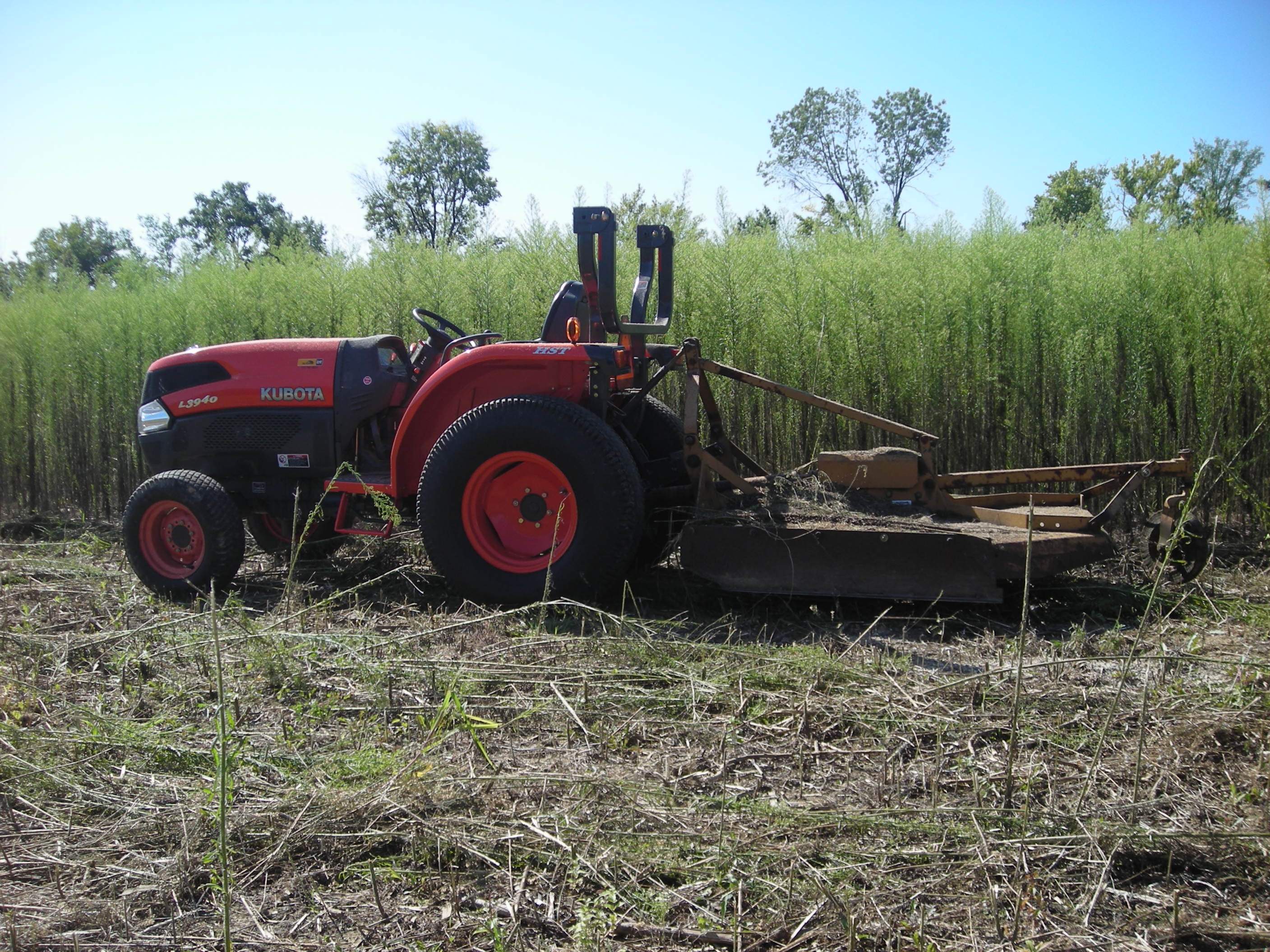

I cut this all day long. Only time it overheats is when the radiator screen is clogged. Philip.
