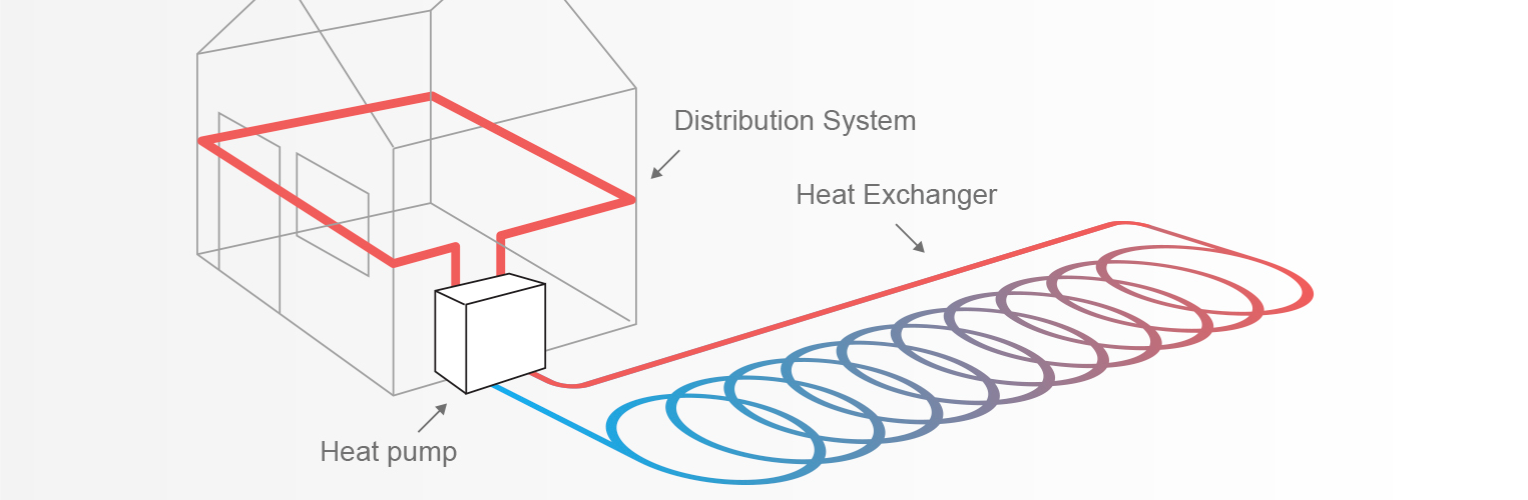

I have a rental house with an old oil furnace and hot water baseboard heaters that needs upgrading. Has anyone done an air to water heat pump or geo to water heat pump and then pumped the water to hot water baseboards?

I don't think a heat pump will heat the water to a high enough temperature to operate baseboard heaters. Plus there's no way to take advantage of the reverse cycle of a heat pump for cooling using baseboard heaters because they would be dripping condensate if you ran cold water through them. If you want heat pump technology, look into minisplits.

Were yours not able to keep up with the colder temperatures? North Idaho is considerably cooler than Western Washington where we have a very mild climate. I have read that there are models of heat pump water heaters that can heat the water to 150 degrees. I am basically looking for this type of setup:

The short answer to your question is "yes, it is possible to use radiators with a heat pump".
The long answer is that it would be unwise to just plug different components into a heating system and expect them to work together. It really needs to be designed as a whole to ensure that it's going to work properly.
We installed an air-to-water heat pump system that produces 40C (104F) water for underfloor heating, or produces 50C (122F) water to heat the domestic hot water tank. Once a week it will heat the hot water tank up to 80C (176F) for a disinfection function. So our unit has the ability to produce temperatures in the range of what you're describing, but one of the things to consider is that the efficiency of a heat pump decreases as the output temperature increases, so our system is less efficient when producing 80C water than when producing 40C water. That's one of the reasons that underfloor heating is popular with these systems. There is a large surface area to release the heat from lower temperature water, the opposite of radiators. Some calculations and thinking would really need to be done to determine if buying an expensive heat pump and running it at low efficiency to produce the hot water needed for the existing radiators would be a good tradeoff against an less expensive "boiler" heating the water with fossil fuels or electricity.
