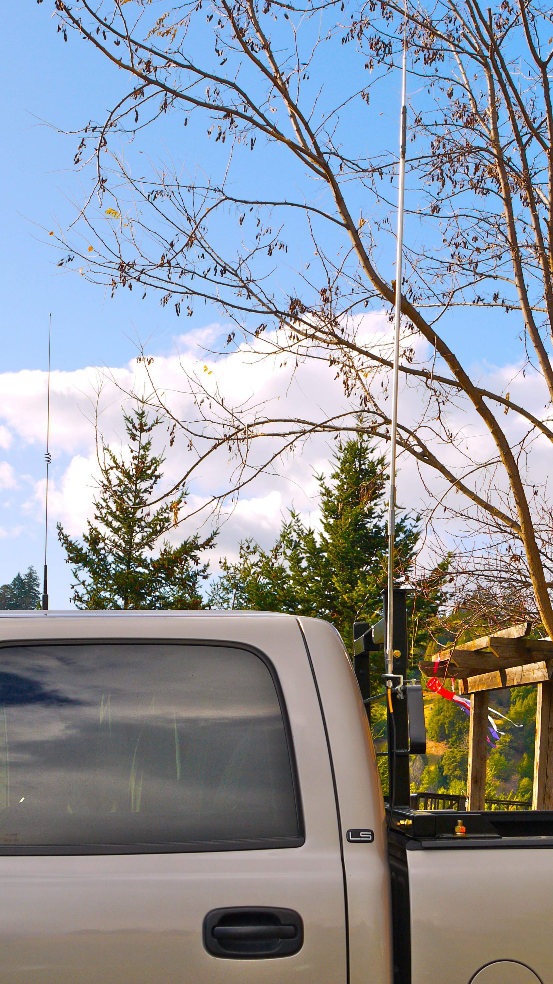

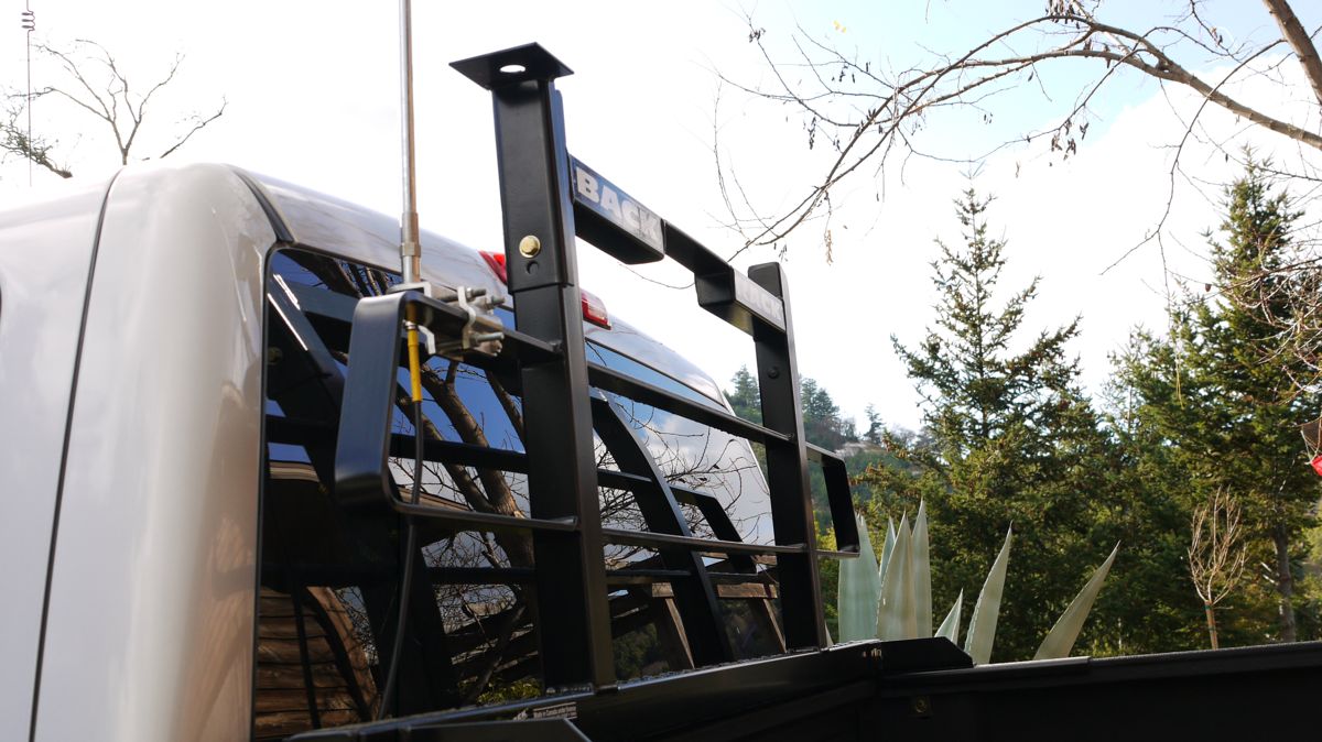

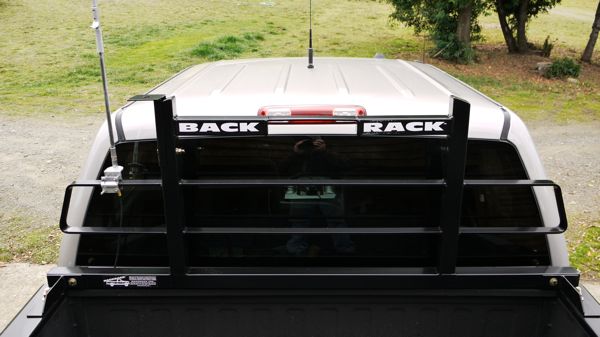

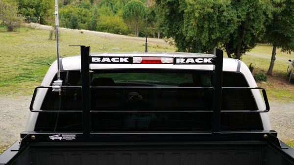

The pictured Back Rack bolts to top of the bed and comes off in about 5 minutes.It has minimal space between it and the window of the cab. It may or may not need to be removed depending on the 5'er. A box could sit under it and be flush with the front of the bed. It functions well for carrying lumber etc.

Interesting rack, never seen one quite like it before. I noticed the bracing is on the square horizontal bar across the bottom. Does the vertical flex much with a heavy load set against it?

I have not experienced any flexing with loads. It seems to be very strong. Since it is a shortbed, and I do have a 5'er, I am concerned about clearance, although I do have a sliding hitch. Haven't put it to the test yet.
