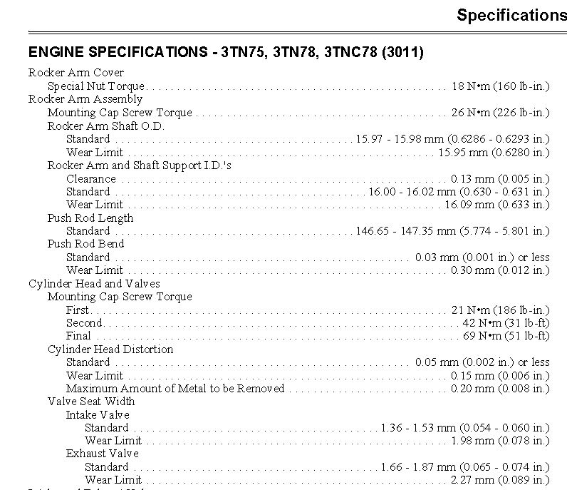

Does any one know what the proper torque for the head bolts are for this engine? It's a Yanmar 3TN75RJ. Rocker arm torque would be helpful too. :) Z

Is this info enough?

Thanx, I do believe that's what I need. The torque seems kinda low, but I guess if its out of a repair manual it'll be correct.

It is direct from the John Deere CTM3 factory manual.
