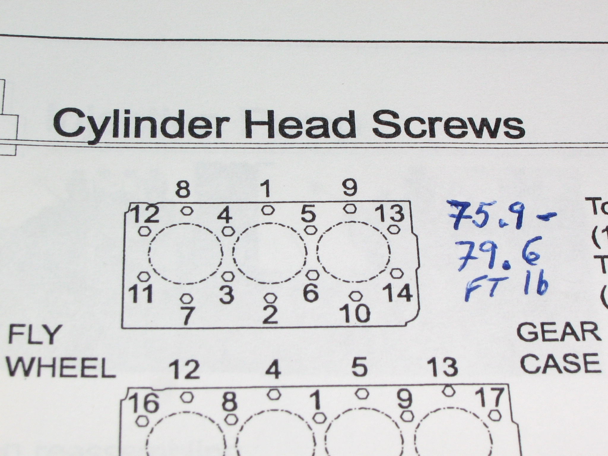

Head bolt Torque for 270
   / Head bolt Torque for 270 #1
trac
Gold Member
Jun 3, 2004
275
Niagara County, N.Y.
Long 530, 2360, 360,2310, Ford 641, 8N, 2N
Head bolt torque 75.9-79.6 ft. lbs.+ sequence for Farmtrac 270. Hope this helps. Trac
