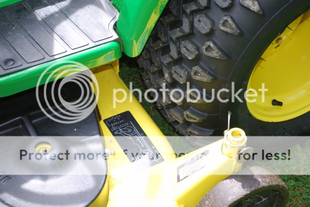

Does anyone have any advice or suggestions on adding HDAP tires to the the John Deere 455? My 455 is a 2 wheel steer model with 26x12-12 turf tires and 60" deck.
The clearance between the deck (when raised) and tires is already tight and I'm concerned about rubbing with the HDAP's. I'd hate to spend $200+ on a new set of tires and have them not fit.
I'm not really wanting to put a set of ag/bar tires on, but still have some added traction for rough areas and wet conditions, so I feel that HDAP is the best compromise for my intended use.

Have you measured a set of the HDAP tires to see if they will fit?
I have these 26 12/12 hdap tires on my X749 and could measure them for you. Don't know the brand of the tires right off.

No Problems at all I am running HDAP Tires on My 455 best of both worlds I think.
Few Pics for you

Thank you very much for the pictures and good news 2001gagt. Could you please tell me the exact tire size?
   / HDAP tires on the 455? #5
Pretty sure they are 26x12x12 I will check tonight and see, I have chains on right now but I should beable to see the size.
