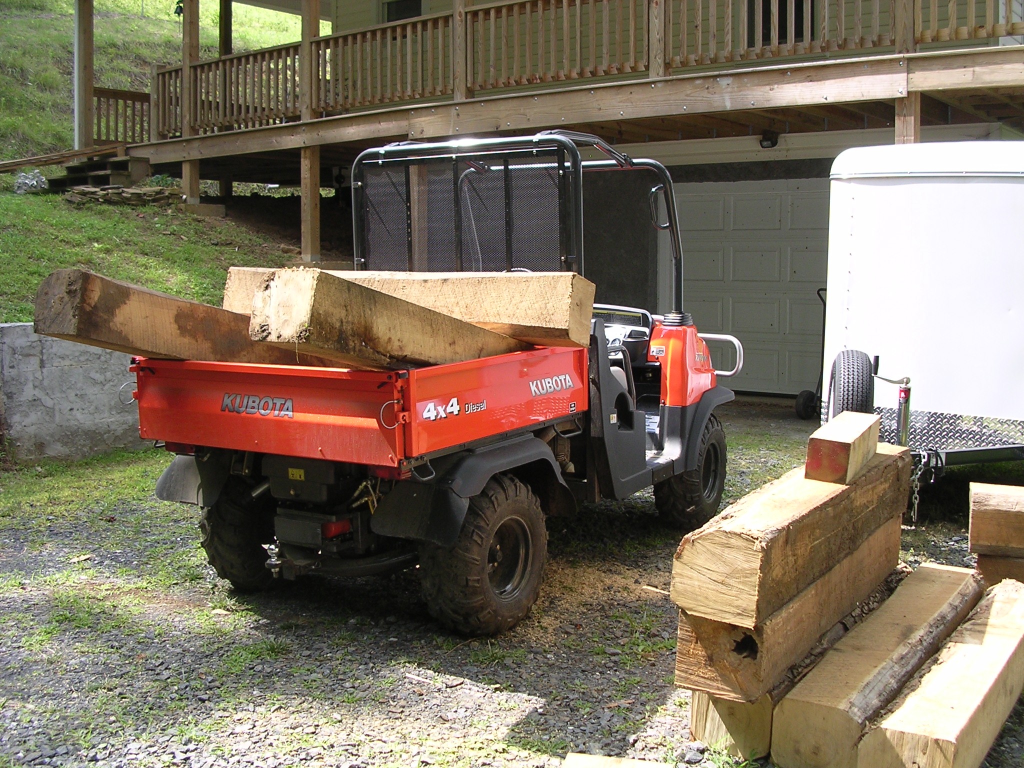

Got a question for you experts on here. I have a 06 RTV with full metal cab and was wondering if the heavy duty struts/springs are necessary if you have the 2" lift kit installed. Before lift kit the front end squated a bit, now it is basically even with the back. I also have 27" tires if that matters. Any help would be greatly appreciated.

Here's a picture of mine at work recently.
