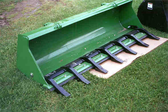

See attachment for view of my JD HD bucket that I bought for my 4710. Note reinforced sides and bucket lip with bolt on cutting edge. The HD bucket is heavier gauge steel and very well built. Not sure on the weight....maybe 75-100lbs extra than the standard bucket. I'd recommend the HD bucket if you're planning on moving around heavy material like stone. The standard bucket with its light gauge steel will likely bend and warp when handling heavy loads. I'd also suggest getting the bolt on cutting edge as this could easily be reversed or replaced after sufficient wear occurs.
As for the telescoping draft links...GET THEM. They are a real convenience and makes hitching up your 3PH implements so much easier.
...Bob

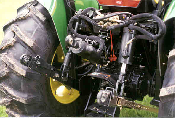

iMatch may be the cat's meow for some, but it is not for me- I have too many implements with too much difference in distance between the draft link pins to work for me. The combination of extendable draft links and the new horizontal bar stabilizers, as shown in John M III's photo, is gonna be sweet. Add to that a hyraulically extendable top link ( as in Top'n Tilt ), and you can hook up to virtually any cat. 1 implement with relative ease. Keep in mind, if you have/will have any PTO powered implements, such as mower, tiller, you'll have to get off the tractor anyway. In short, iMatch is slick, but it is limited.

<font color="blue">"...The combination of extendable draft links and the new horizontal bar stabilizers...is gonna be sweet. Add to that a hyraulically extendable top link...and you can hook up to virtually any cat. 1 implement with relative ease."</font>
Add to that the hydraulic side link as shown in the attachment and one is good to go for almost any field operation. /forums/images/graemlins/laugh.gif /forums/images/graemlins/laugh.gif
