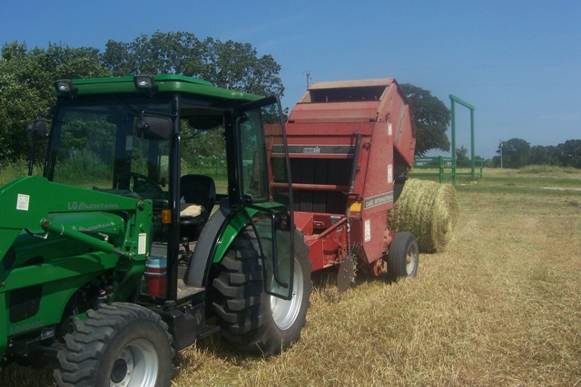

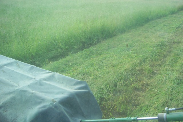

FYI ... I run a 43 hp tractor, use a DM 1160 disc mower and a Case IH 8430 round bale that puts out a 4x4 round bale no problem.

and did 500 bales this year ...
I have a 43 hp unit and a 60 hp unit and both may do the job but for an all in one tractor it is far better to move up to a tractor large enough to handle ground engaging tasks as well as the haying equipment. A 75 hp tractor is a good fit for small farms and ranches needing an all purpose tractor.
