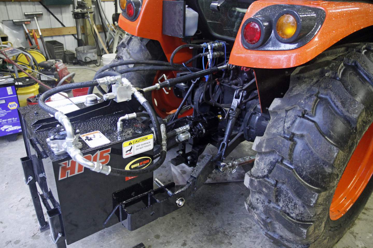

I looked into a similar issue last year. 2 issues raised their ugly head.
1. These style of mowers are designed for 3,000 PSI drives (skidsteers) and not the 2,500 PSI of tractors.
2. When using the mower, you have essentially diverted all available hydraulic flow necessary for the operation of the tractor.
I ended up installing a 3 point , 25 gallon reservoir of oil with a pto mounted 3,000 PSI , 15 GPM pump. Im only running a snowblower at this time, but plan on adding a loader mounted post hole digger, etc in the future. The tank also adds about 500-600 + pounds of rear ballast.
