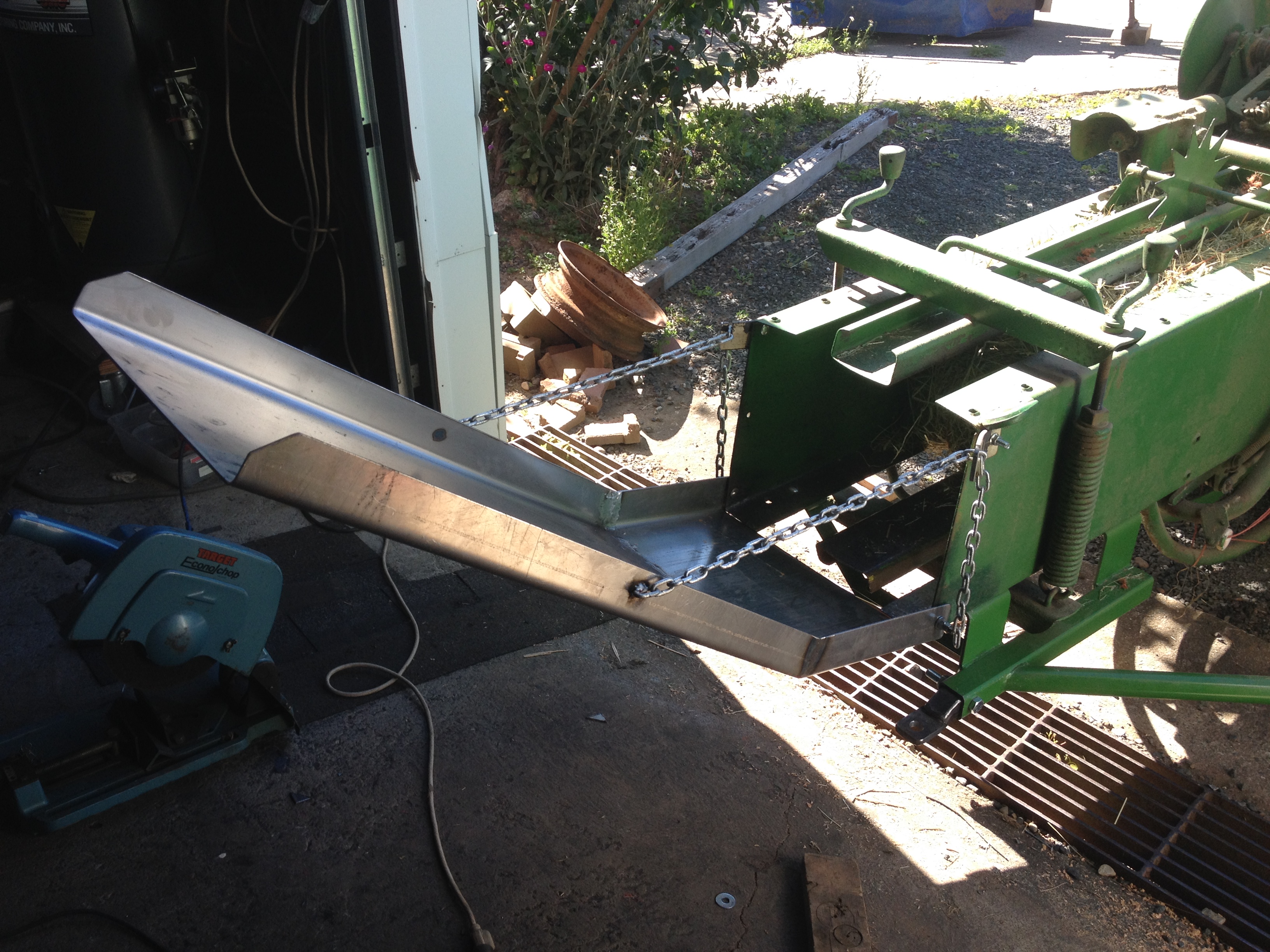

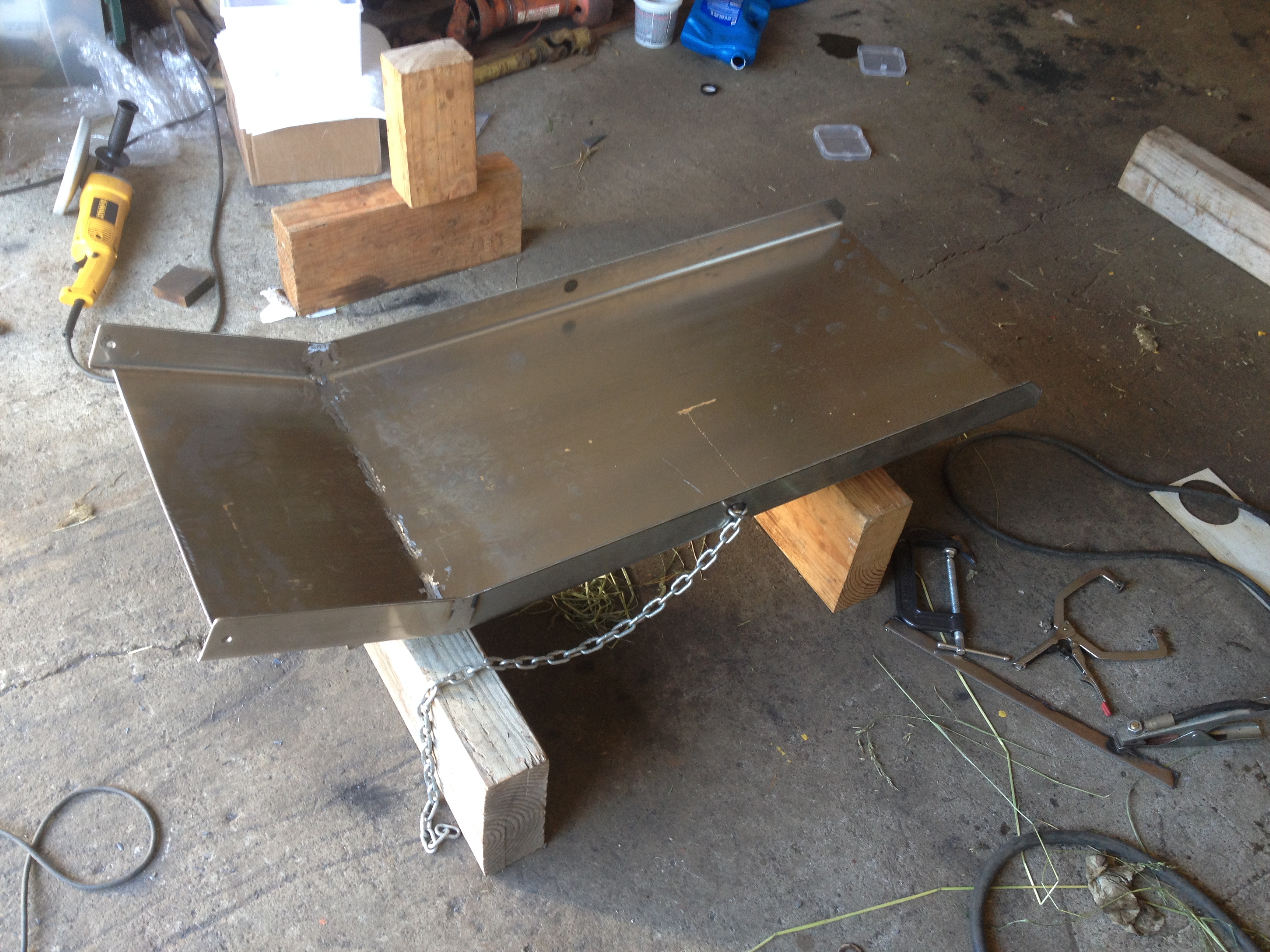

Apparently I don't have any good pics of my wagon frames... I'll have to go take some. For now:
Back end of the hitch and the bale chute.
It's hard to make out in the pic but the hitch receiver tube ties into the bottom of both sides of the bale chamber. The hitch pin plate is welded to a square tube that slides inside the receiver tube to allow adjustable length, however I keep it about where is in the picture. The diagonal member bolts to the right hand axle mount to deal with very significant side loads applied while turning, also the reason for keeping the hitch pin close to the bale chute... i.e. a shorter lever.
The first "stage" of the bale chute coming right off the back of the bale chamber is a little too short - the bales get bananna'd a bit. Two shallower angle bends about 18" apart, the first 18-20" from the back of the chamber instead of around 12" would have been better. Make the bale chute and wagon tongue little longer to get enough height and clearance to the wagon deck.
A bit of an aside, but you may as well learn from my mistakes - I've had the chains bounce off their hooks twice while manuvering/traveling across the field without a wagon and didn't notice until backing up and seeing the baler get jacked in the air... tends to bend the heck out of things!
