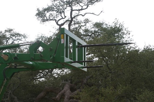

After almost a decade of owning a John Deere 770, I had to sell it to get something that would be a bit more functional around the farm. We need a better way to move round bales around so with the bigger tractor comes FEL and 3pt hay spears. I picked up the main spears for a little over $60 with shipping. I turned the smaller spears and retainer bushings myself.
Here’s the FEL spear.

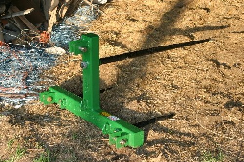

Here is the 3pt spear.

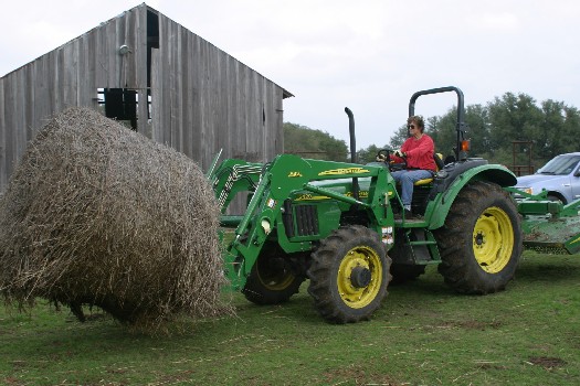

Action shot. Not sure how much our bales weigh, but the tractor handled them without any problem.

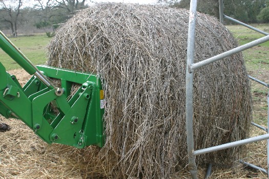

If we don’t get stupid with it, I think this attachment will last as long as the tractor.

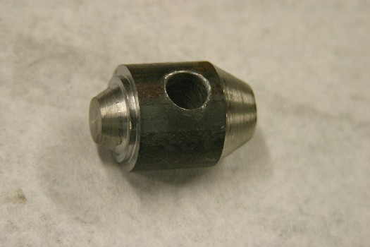

For the FEL hay spear, I turned the lower Quick Attach retainer pins myself. The left hand side was tapered to fit in a hole cut in a 3/8 inch thick plate. The taper allows me to get a good penetrating weld bead while insuring the pin fits plumb against the plate.

I made the smaller, lower spears myself. I have a medium size lathe in my shop where I can turn small tapers as well as make the sockets spears bolt into.
For the larger spear, I got off a dealer on ebay. They were cheap (under $70 with shipping), but I'm wasn't too impressed with the quality or their service.
