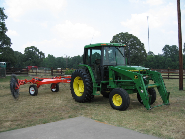

I have two old David Bradley Side Delivery hay rakes that I have been trying to use to make hay. The rake has three real issues. One it likes to slide down side hills. Two it tends to rope the hay. Three it balls the hay badly if it is heavy. Any suggestions for improving the operation of this antique?
With all of the problems I am having with the DB, I am seriously considering a modern rotary rake. I have read the literature on Kuhn and Pequea, but recently came across Morra rakes. The Morra is ~1/2 the price of a Pequea and ~1/10 the price of a Kuhn. I am only working 10 acres for my own horses, so it is hard to justify too big of an investment. Anybody have any feedback on these units?

For years the farm where I work part time used tandem side delivery rakes on about 200 acres of hay to make what amounted to be one big rope of hay. Then about 6 years ago they switched to a left and a right side delivery with a hitch that still allowed one tractor to double windrow but instead of one giant rope now you had 2 med. sized ropes side by side. Now this winter the boss was at an auction and purchased a large wheel rake and after one cutting he is convinced that it is the way to go from what I see on the net the prices of new ones are not that bad you might want to look into one.

I used a New Holland side delivery rake for nearly 25 years before buying a new Kuhn 110 Speedrake last year. It's cut my raking time by over 1/2 and does an excellent job of raking.

I'm a Kuhn Dealer, and I would have to say they are a good Rake, however, stay away from ones that are over 4 Years old as they had a Gearbox upgrade that is very good (look at the GA300GM). I have also thought about being a Vicon Dealer (they seem to be constructed very well, just don't have the ease of adjustment of the Kuhn).
You are not alone in your roping problems using a basket Rake-we have experienced it here even with a well adjusted Rake, although in the proper conditions they can still do a great job-
