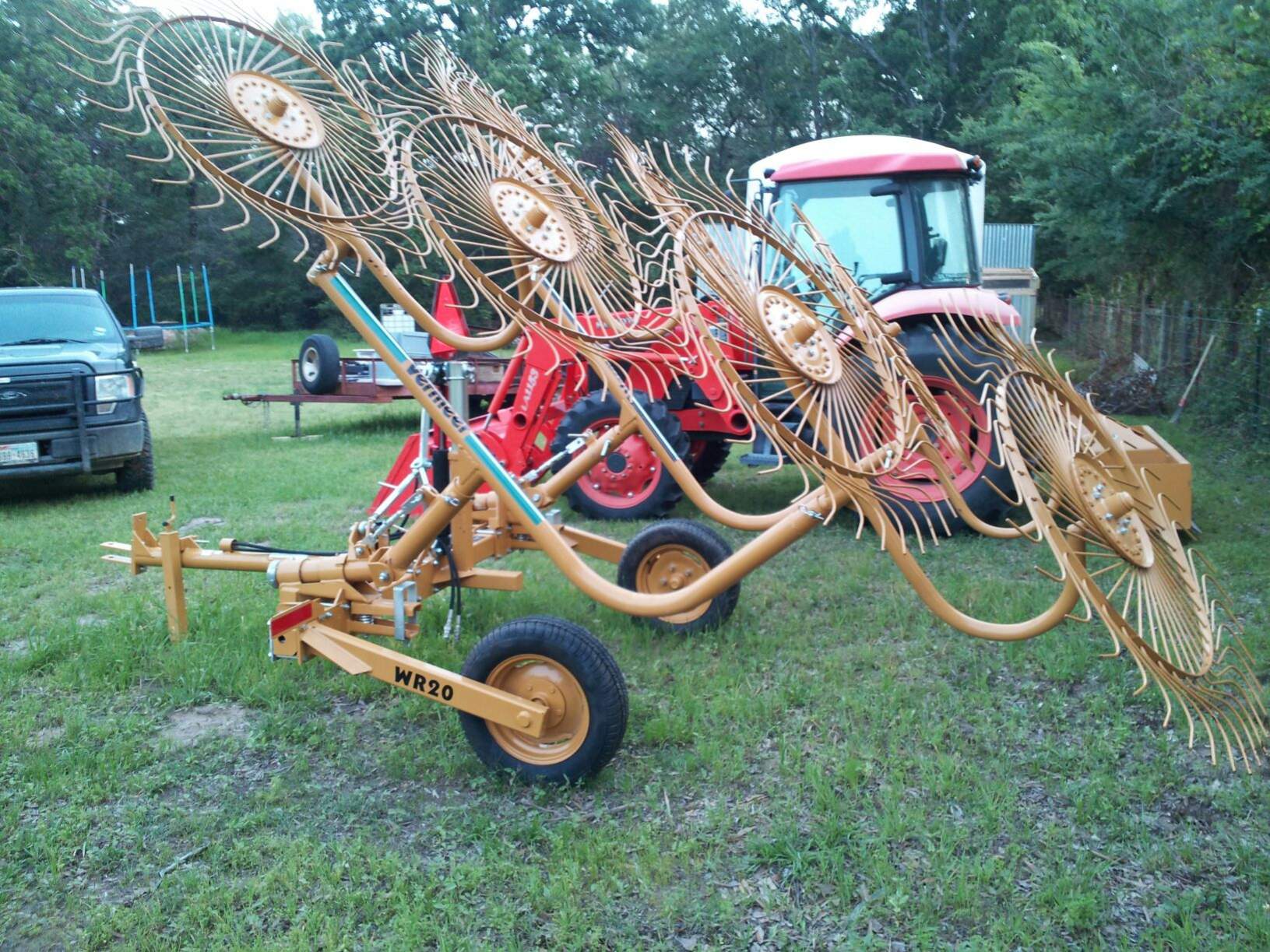

I just got a new Vermeer WR20 8wheel rake $2500 hay rake.jpg,been seeing alot of Kuhn lately,havent ever got to use anything other than the Vermeer...

I just got a new Vermeer WR20 8wheel rake $2500 View attachment 264334,been seeing alot of Kuhn lately,havent ever got to use anything other than the Vermeer...
How does a wheel rake like that compare to a side delivery rake?
Been looking at adding a 2nd side delivery rake and a dual rake hitch, but that would run almost the same price as that wheel rake (minimum of $2000 to buy the rake and hitch), running one side delivery rake too slow at times whenw e need to merge several light rows.

I can only go off what I have heard that the rake you are using get less dirt in the windrow. In years with several different folks baling are place have never seen anything but a wheel rake used,and when I baled years ago I only ran wheel rakes. I guess most use them cause its low priced and gets the job done but I would bet if gonna sell horse quality hay would wonna use something like you have or the big dollar pto rake. I found a vid [ame]http://www.youtube.com/watch?v=aeIoeGG4PEM&feature=player_detailpageeo[/ame]
