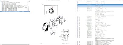

Anyone know the belt size or part number of a MF model 25 hay rake. Ours broke.

Well it took a 7/8 *97 inch for others that search

I'm a bit late to the party, and you've got your answer (or close enough to work) already. But if you log into the agco parts book online you can find pretty much all the Massey info you need. Attached is a screen shot of what I believe you were looking for. Wish I'd seen this sooner.

I could not log in as we don't have a dealer close and the one I called was not interested in giving me a log in over the phone or a length, would order it though for roughly 3x What I paid for the one I got . 100 is what I got when I measured the pully's, but the old belt was 97 and fit with the adjustment half inch from shortest. Thanks for the post up though.
Edit I found a site that lets me log in thanks.
