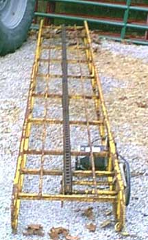

Here's another project in the making, one section of a 16' hay elevator. This was welded up out of 1" square tubing, 1/16" wall. I used a couple magnetic welding squares for all the 90 degree angles. Made the fabrication go a LOT faster. Cold-rolled rod was welded into the two section that will be in the middle of the elevator for added strength. The sections will be compatible and will bolt up to Snowco sections. I have included a photo of the project, and another of a used Snowco elevator. This one sold for $795 used!
Used Equipment for Sale Pg. 1 With all parts and material, and a used 1/2 or 3/4 HP motor, one should be able to build one for only a couple hundred $$.

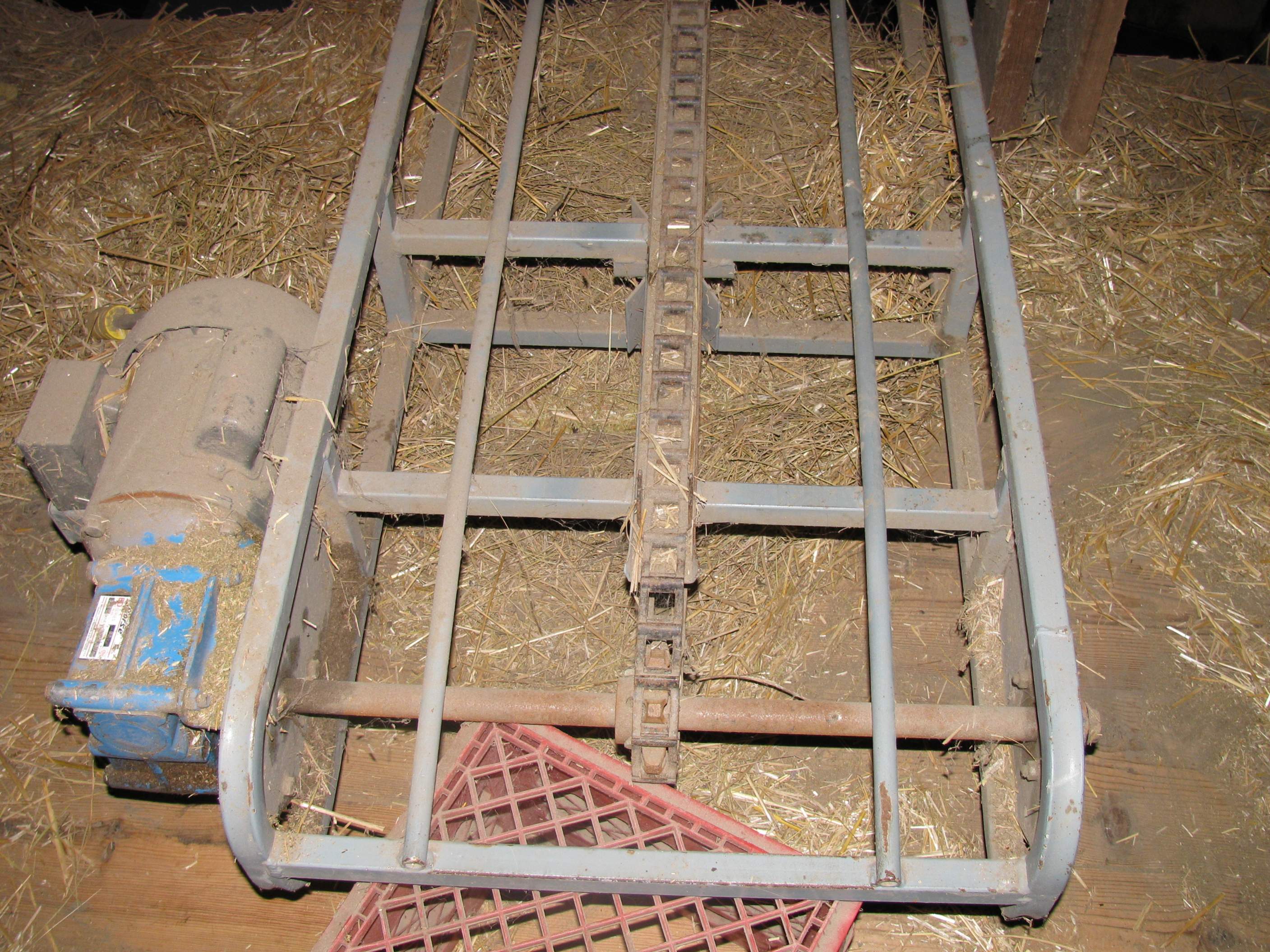

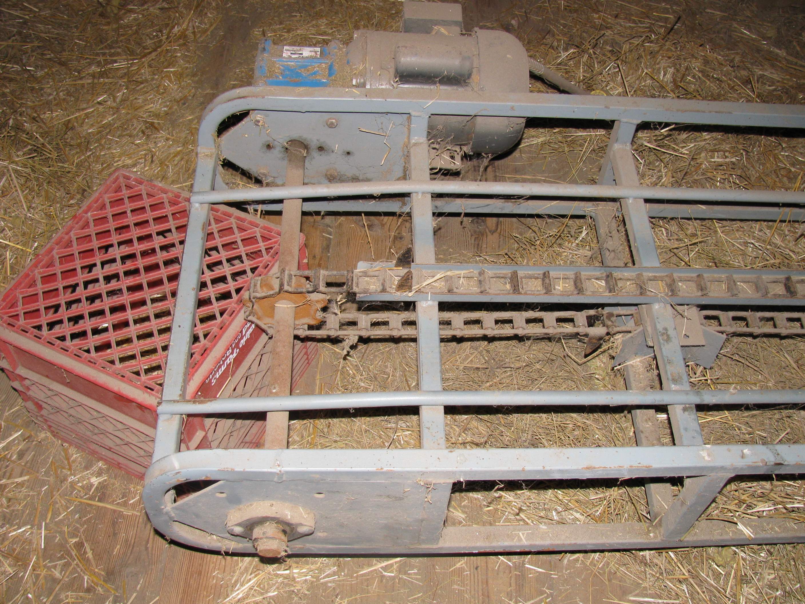

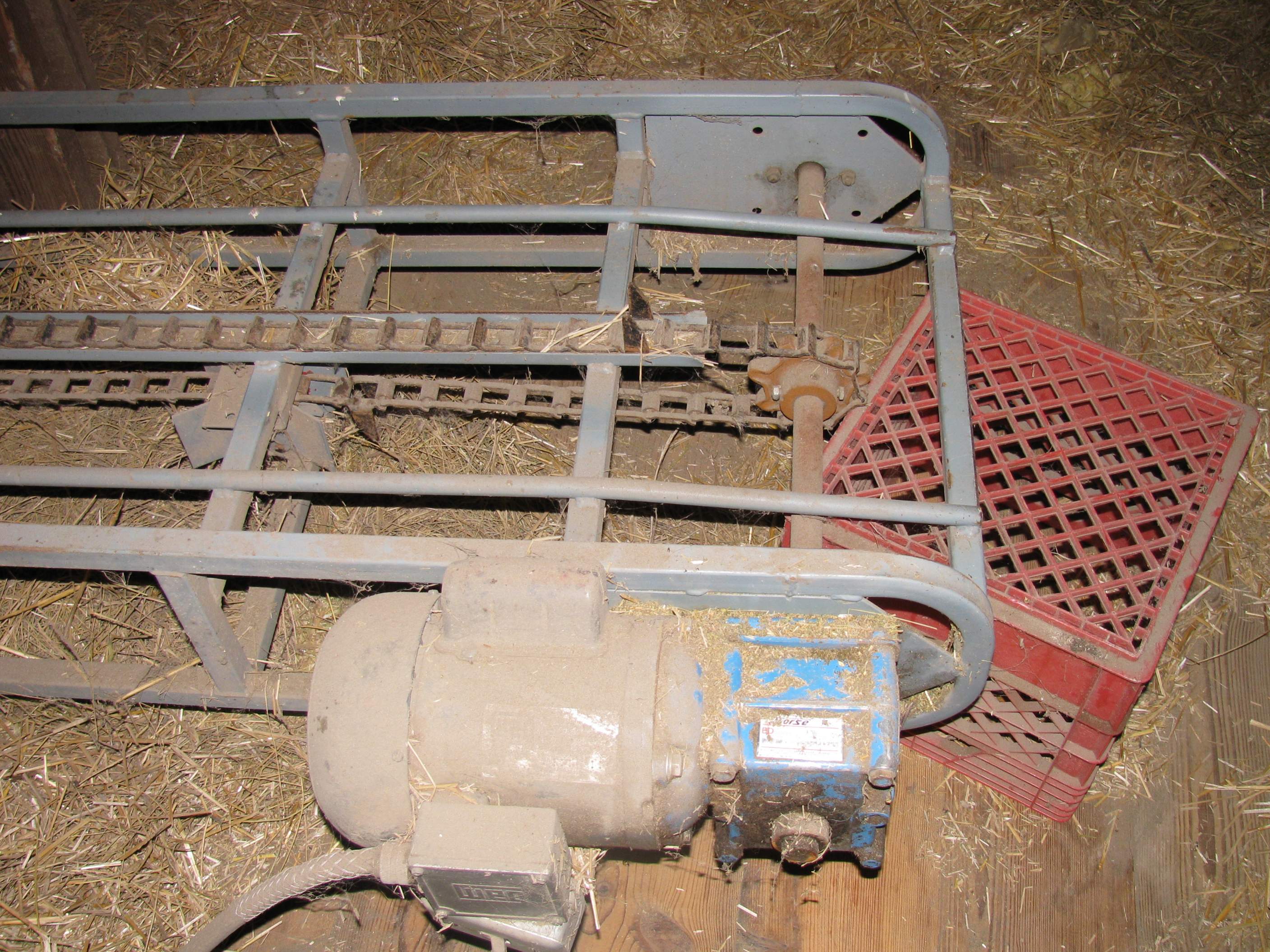

I made my own a few years back. I made a jig to hold the rails and spacers in place while welding, Used a tubing bender to make loops on the ends. I had a fab shop bend the upper guide for the chain, I bought the return guides and sprockets from Snowco. For the drive I used a 15 to 1 ratio right angle drive with a 2/3 C-face motor drive. Chain came from Sloan Express. I won't be home for a few days but can get pictures of the drive and tail end if you like.

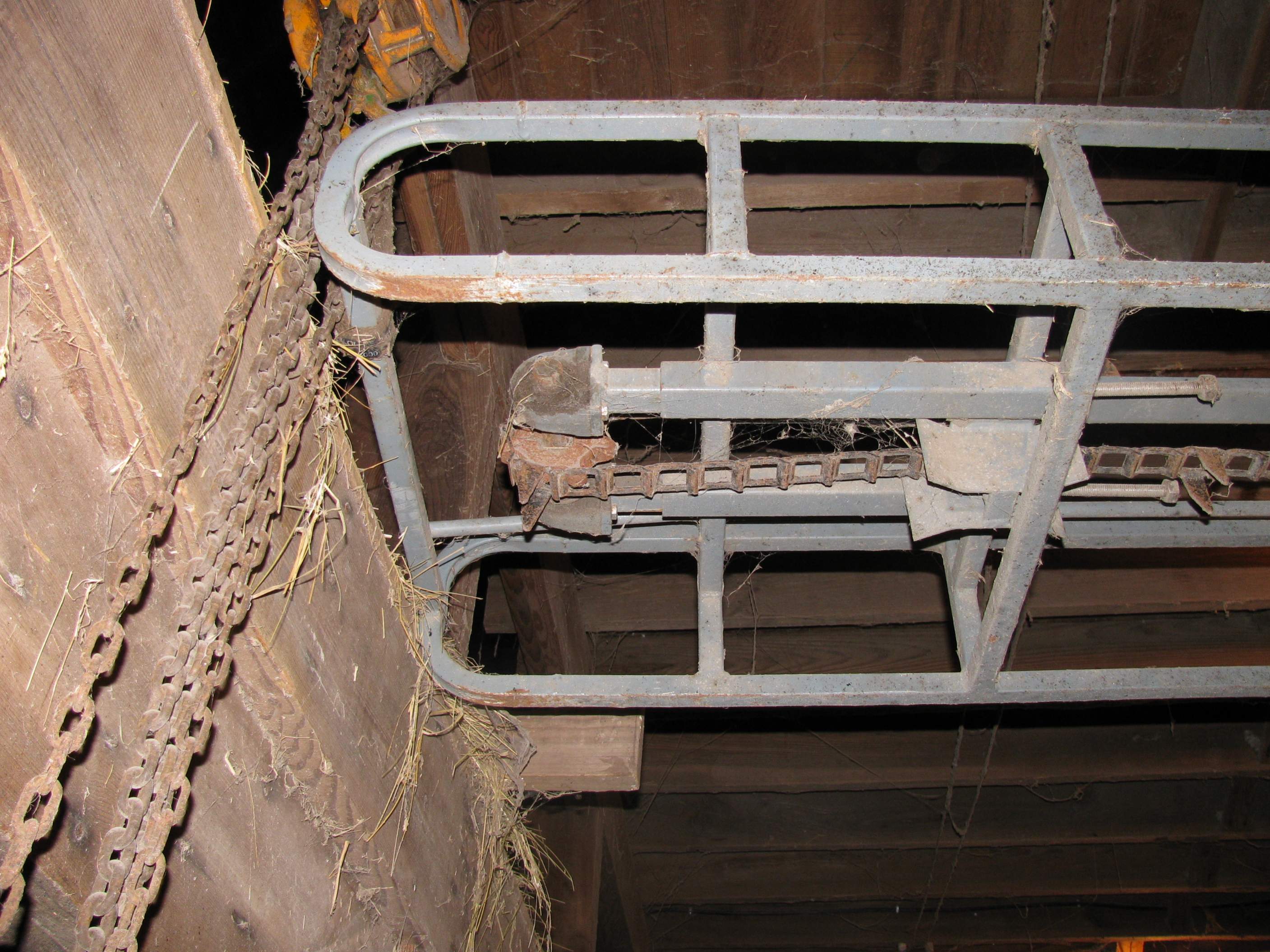

Here are a few pictures I took tonight. The bender was one of those you bolt to the floor and has the big arm you pull the tubing around a die. I could not make the end loops in one bend. I made 8 loops, cut them as needed and welded them back together. All 1" tubing.
If I were to build another I would use lighter gauge steel and fewer cross braces. The thing weighs quite a bit. The chain return guides and sprockets came from Snowco. The chain track was bent at a local metal shop. I made a wood jig to hold all the ladder parts square while tack welding. I used the deck on my goose neck trailer for a work table. I think it is 18' long but I can't remember.
The bad thing is there is no belt to slip in case someone gets tangled in the chain.
Dan
