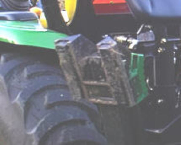

Hay Duc i got a little info today:)
the 448 foot is part# KV16827 and there 215.00$ a pair.
the 47 foot is part# M137931 and there 115.00$ a pair
The rubber street pad for the 448 and the 47 hoe is the same number
BM19556 and there 101.00$ for both sides.
The dealer did not have eather one. so i could not look
and thay did not know if eather would fit a 46 hoe..:(
Can someone tell me if the foot on a 448 is cast or steel. if its cast , it is not easy to weld. if its steel i know i can make it work...:)

Hopefuly my tractor will be finished and ready monday. as soon as i get it. After a little play time of course......:D . this will be the first thing i work on . as some of my projects require me to be on pavement. so i need to work it out soon.....;)
I really wish brett would be so kind as to post us some up close picture of the top/side/ and bottom of the 448 foot. so i have a pattern.
Where are you Brett?.....:)
   / Hay Duc check this website about flip pads
Duc , here is a close up of bretts foot on his 448. and another at 100% crop.
I read where he says its cast.....:( not easy to work with. i may haft to make them from scratch....:rolleyes:
