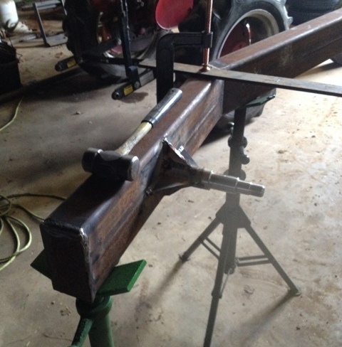

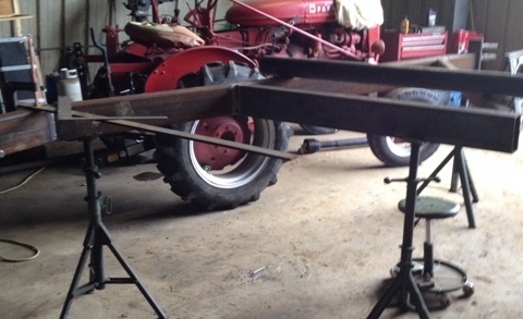

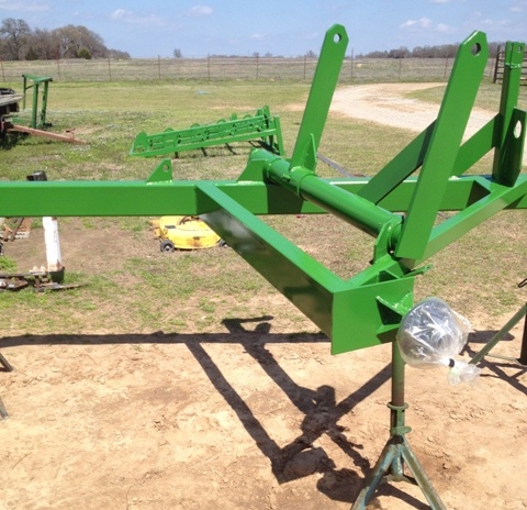

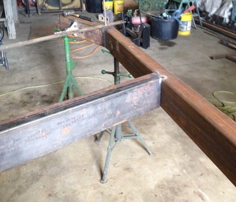

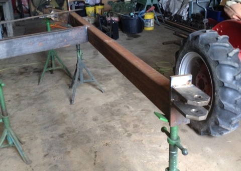

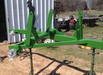

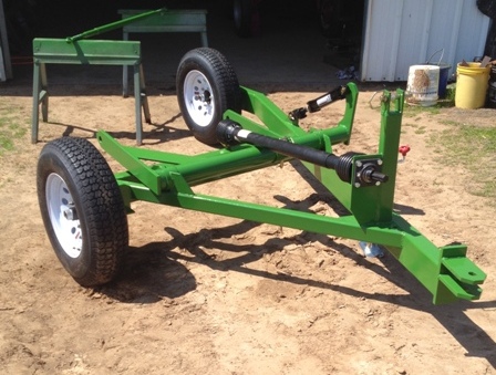

Had a customer order a hay caddy for his disc mower.
   / Hay Caddy Build
#2

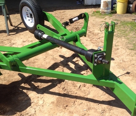

So I built him one.
   / Hay Caddy Build #3
very nice. but I have to admit, I don't know what a hay caddy is. Your fab skills are great though.
   / Hay Caddy Build #4
Looks like a trailer for a 3 point mower.
Bruce
   / Hay Caddy Build #5
I have a KMC caddy for my disc mower. Sure makes life a lot easier. It takes a litte getting use to, but it works good.
   / Hay Caddy Build
Thats its, a trailer so to speak for your disc mower. I believe the hardest thing with a disc mower is hooking up to the 3 point of the tractor. You just never seem to be lined up just right to the 3 point and when you do get hooked up then leveling out the cutter with the top link.
This unit always stays hooked to the mower ... makes it "plug and play" ... back up, drop in the hitch pin and plug in the Hydraulics and go cut hay!!!
