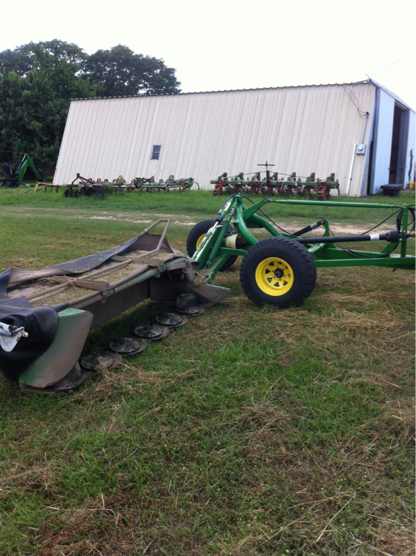

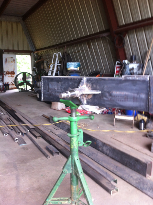

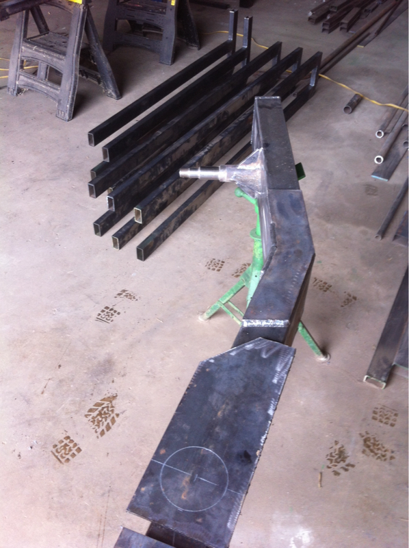

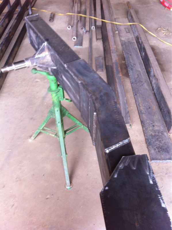

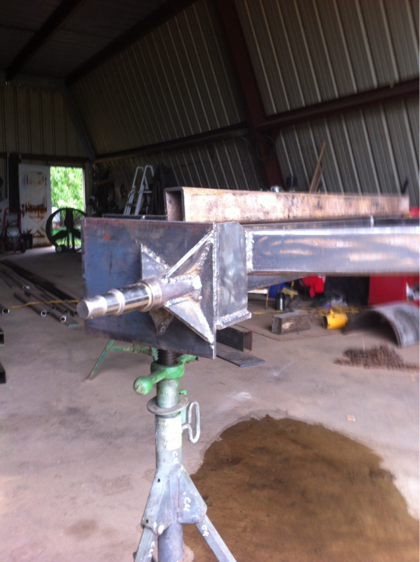

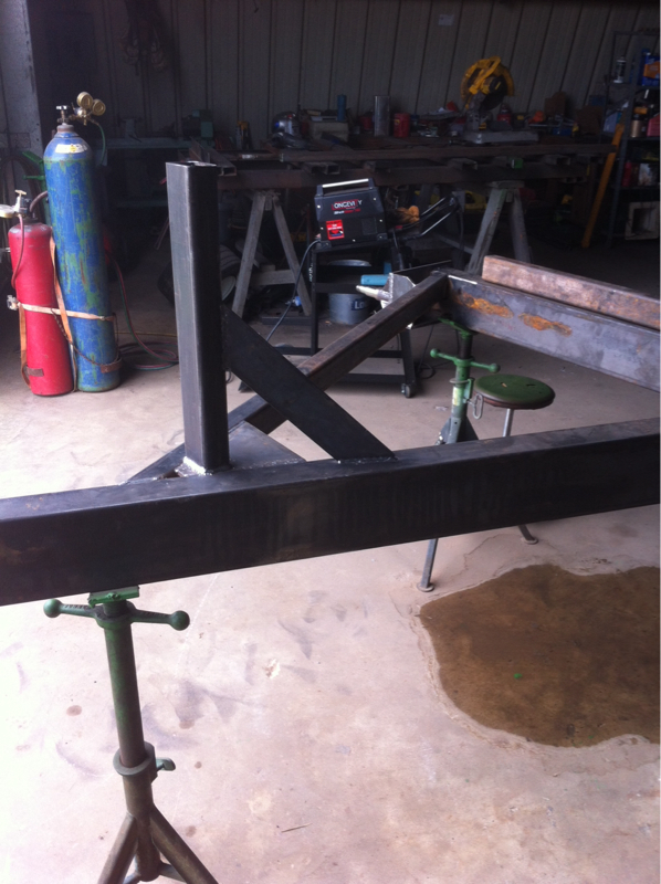

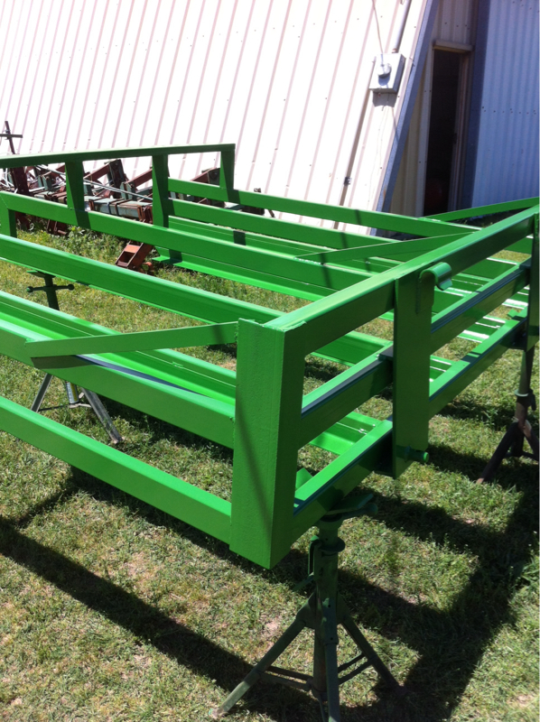

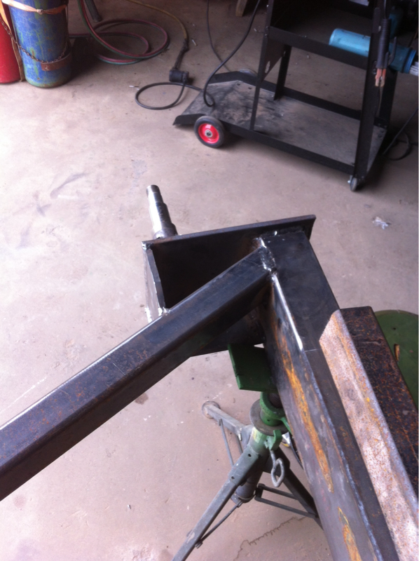

I've been planning to build a hay caddie for my disc mower .. Been getting the parts together and got a start Sunday .. The main frame is 3x6x1/4 .. I'm to the point where I'm wrapping my brain around the lift arms and the hydraulics .. I still need a slip clutch, PTO shaft, pillow bearing and a very long top link .. I'll get it.

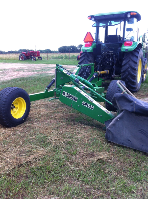

I got her finished up

Looks great how well does it work? something like that would work for my sub compact Massey with a sickle bar mower.
   / Hay Caddie Build #4
Looks great how well does it work? something like that would work for my sub compact Massey with a sickle bar mower. How does it lift the 3ph ect. More info Please.
Works just as it should .. My disc mower is now a pull type !! Never again fight the 3 point hook up

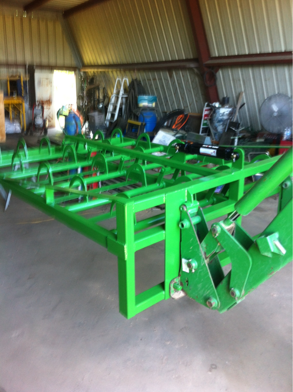

You was thinking about the hay accumulator and grapple unit that I build and sell

OK but why ??? now you have to fiddle around trees and in corners to get your land clean...
   / Hay Caddie Build
#11
I believe the two reasons are ... First I don't have to hook to the three point just back up, drop in a hitch pin plug in the hydraulics and go .. Second it takes the weight off the tractor.
As for trees my hay fields don't have trees in them .. If they did have I'd just go all the way around them cause the cutter hangs out to the side ... Same for the corners
