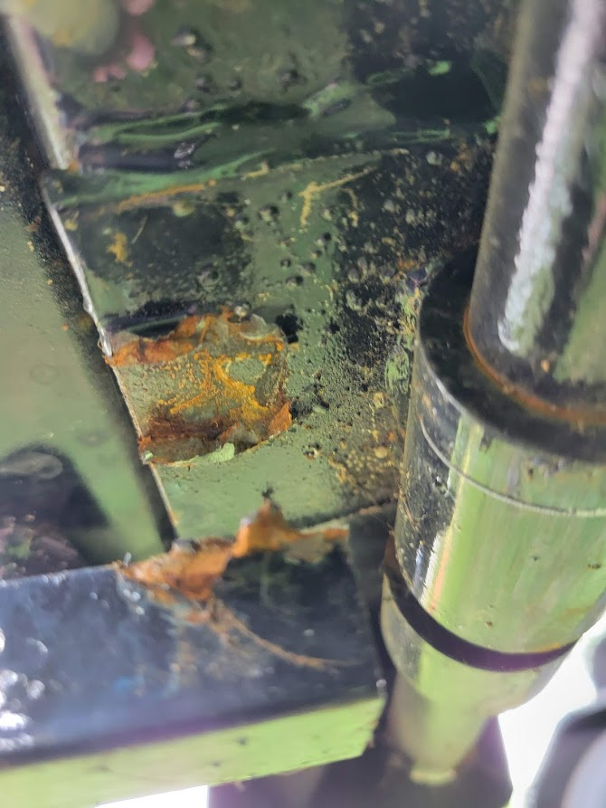

The bar that secures the ramps in place is attached in 3 places, with 2 welds in each point. 2 of those places (4 welds) completely broke and the bar was dangling, and I haven't even used the ramps! Whatever you dump out, does hit that bar, and then the bar sits in whatever was dumped out until you move the trailer. Seems like a common design, but others don't seem to break. I noticed it after the 3rd load. First was fill dirt, second was slag, 3rd was fill dirt. A friend has since re-welded the bar for me.

ahhh......well....That is bad. I trust that wire, maybe 12 gauge, is to a relay. The weld looks like it was TACKED, and they never came back to complete the welding process. Either that, or they need to hire a welder.
   / Hawke Trailers - Customer Service - Experience #5
I may look over the other welds that are in critical spots.....I guess there may be something to say about robotic welding. They don't usually miss spots
