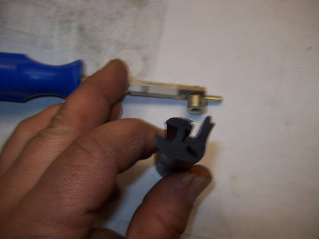

HERES A PIC OF THE INSTALL TOOL AND THAT GASKET.After You get the install done ,you zip it up,it tightens the windows right up.

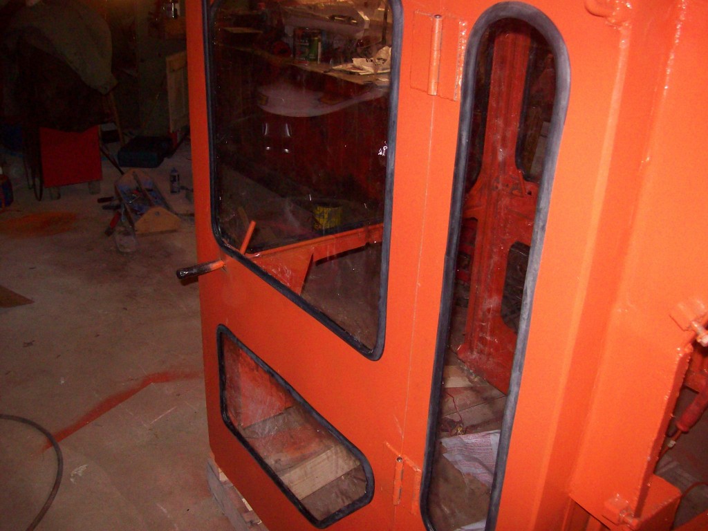

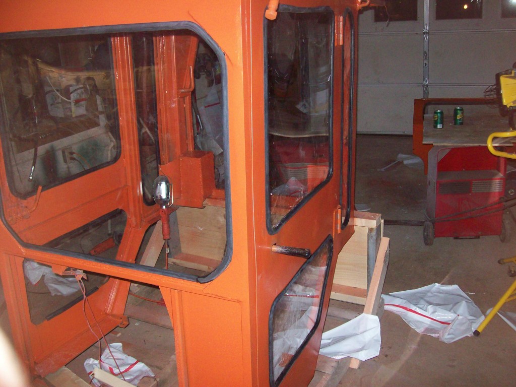

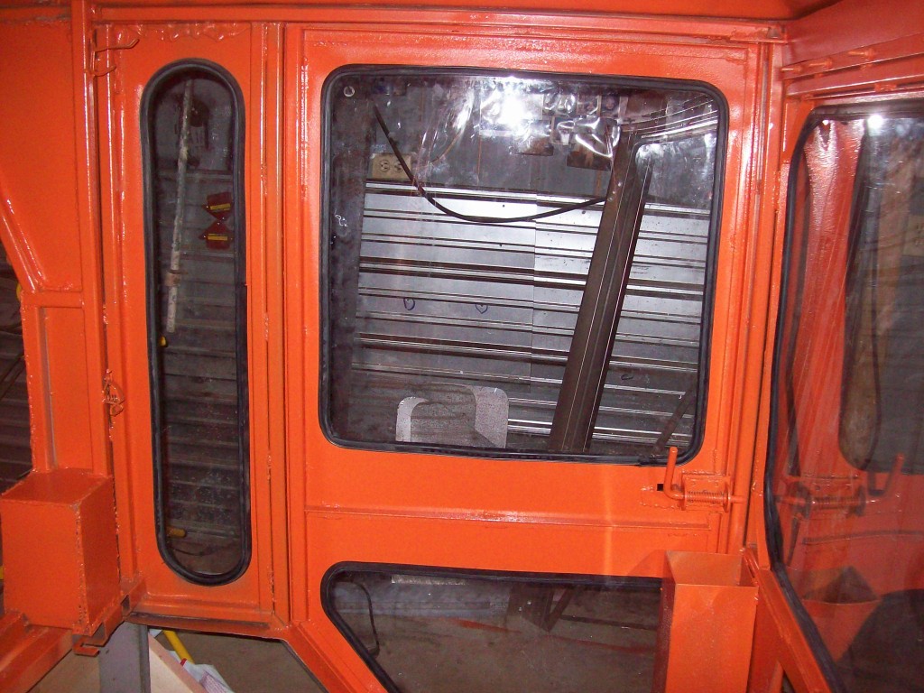

Heres some pics of the lexan installed.The gaskets really dress up the cab.Pay no attention to the finger prints:p
