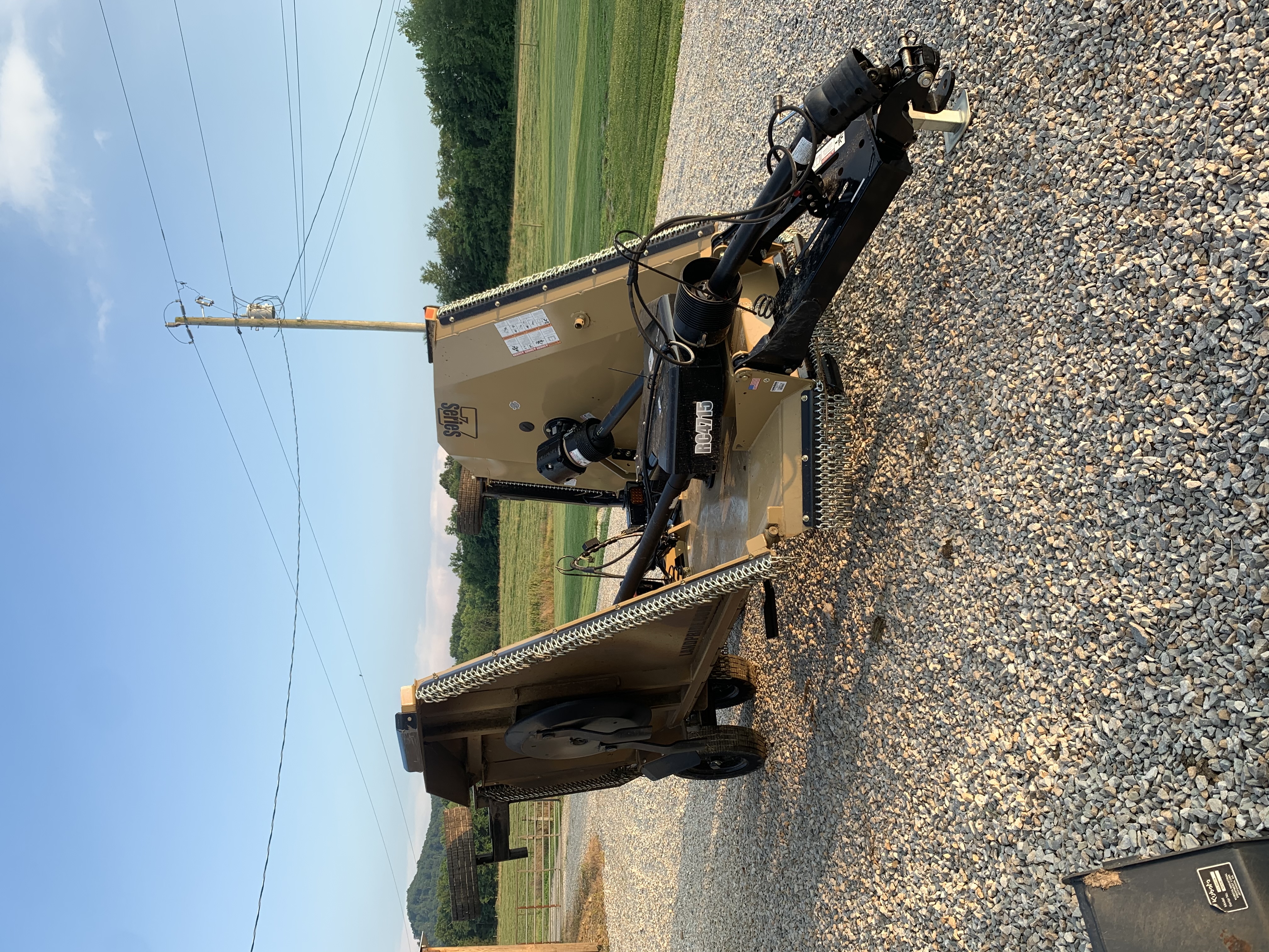

I went with the 4715. $15900. Could have got one for $15300 but the dealer in somerset was a cluster..you know what.
Very satisfied with it.
   / Having hard time choosing between landpride 3715 and 4715. #7
That is a nice mower, I would also agree with the poster that mentioned more hydraulics.
I see just two lines going back, one for the wheel lift on a single action cylinder, and one too both of the wing cylinders also single acting.
An electric diverter could be plumbed in allow one line have split controls. We have 3 lines on the big batwing makes it possible to hold the deck level or up or down slightly for obstacles or too drop down a bit but hold a wing in the air over a ditch.
