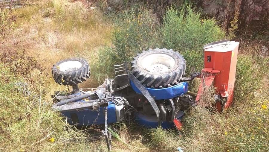

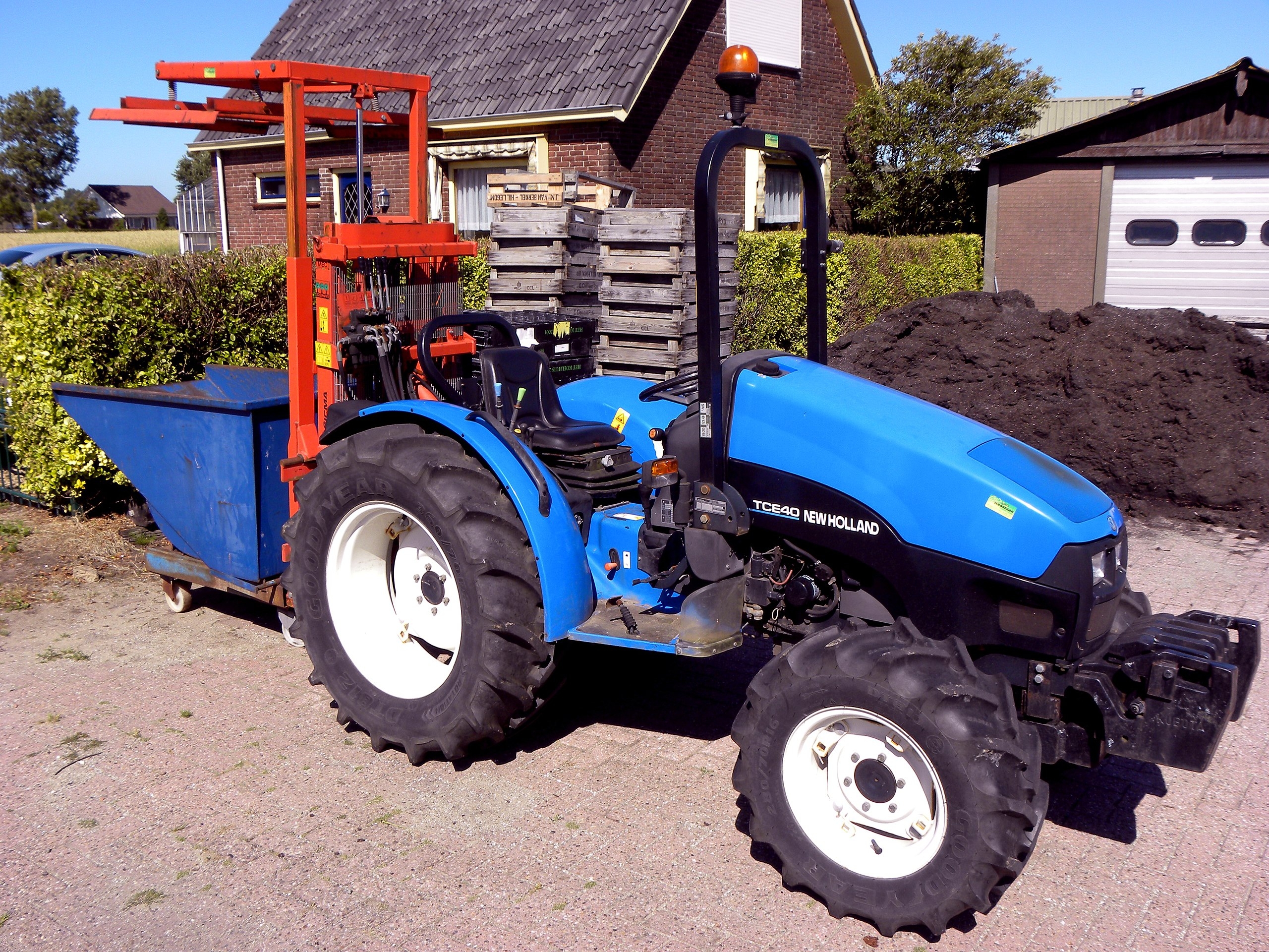

Back in July, a man was using his New Holland TCE40 on the top of a 10 ft tall embankment and ended up rolling the tractor and falling from that 10 ft drop. He sustain minor injuries exactly because he had his ROPS up. It was a mid mounted ROPS too, which I had people telling me it won't protect the operator as good for some reason.
We've a lot of tractor accidents resulting in deaths here in Portugal. Almost one per week in this small country. 99% because the ROPS was down or the tractor was old and didn't have one.
Despite the mandatory "How to safely operate a tractor" course, a lot of people still think the ROPS is there to annoy them and not to protect them. They do keep post pone the mandatory part of this course though.
Sadly, a lot of people who think that way, are not here to tell their story anymore, and this is happening on all ages. One would think the old stubborn guys were the worse, but not, even some young guys think the same way which is a shame really.
I too run the mid mounted ROPS folded since I work on orchards a lot but only because I know for sure I can't flip the tractor in those areas. Otherwise, it would be up which I do once I'm done with the orchards. I work in places I couldn't even have a rear mounted ROPS because it just don't fold low enough.
Well, as usual, I digressed a lot from the original question, sorry about that. But no, I haven't heard anything about a ROPS failing. Only from the ROPS not being up as it should. It's so easy these days too, they put gas struts on the ROPS of new tractors, so you can literally lift that thing with the tip of the finger.

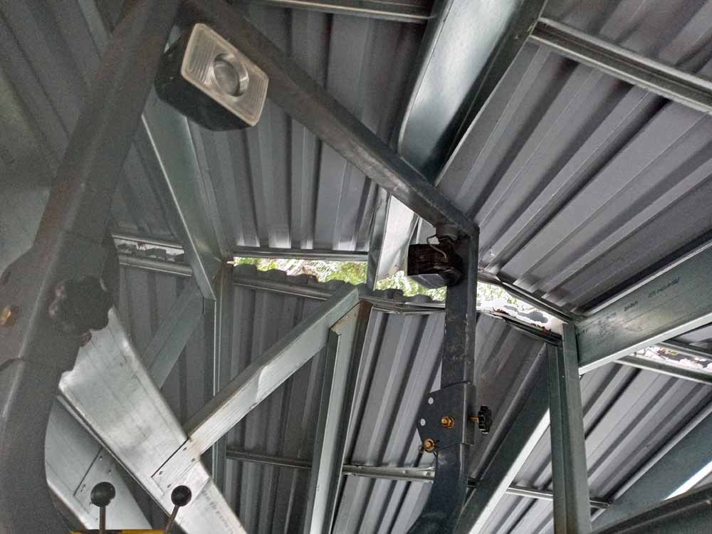

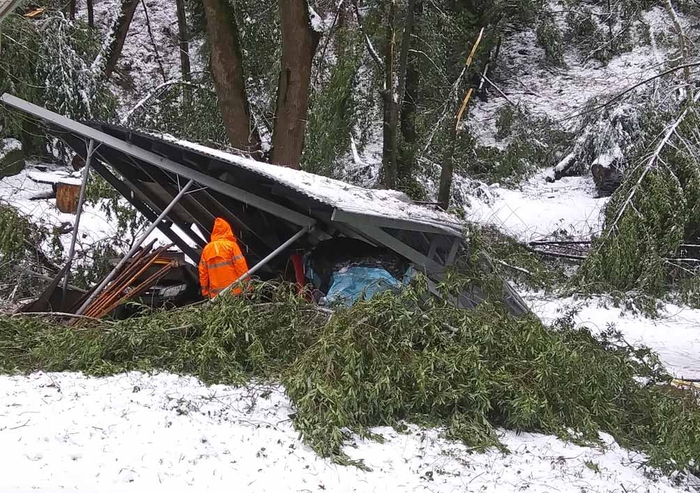

I have a ROPS survival I have not posted about.
We had a 50y event here in FEB 2023, which left 6+ inches of snow on the ground for a week. I probably lost 100 larger trees on my 19 acres. Still cleaning up 1.5y later.
I was in my carport (tractor-port) the morning after the snow, surveying the damage, and while underneath the roof of this structure, a tree fell on it, and caused it to collapse. I had a split second to decide whether to run out from the carport and risk getting hit by a branch, or staying inside and counting on the tractor and ROPS to protect me. I chose the latter.
This building is all-steel, with no walls. Designed and built by me in 2014.
The tractor ROPS held up the roof until I was able to take it apart piece-by-piece, as it was screwed together. Took about a month. A month without use of a tractor. :-(
No damage to the tractor, me, or an ATV inside at the time. Freaky.
BTW, my ROPS is heavily modified, and shortened about a foot. It really stood up well, with nothing more than scratched paint. It is not folded 99.9% of the time.
   / Have you ever heard of a defective ROPS responsible for injury? #10
That's certainly a tractor survival story like I've never heard before! Kinda sucks that it made your tractor unavailable though.
