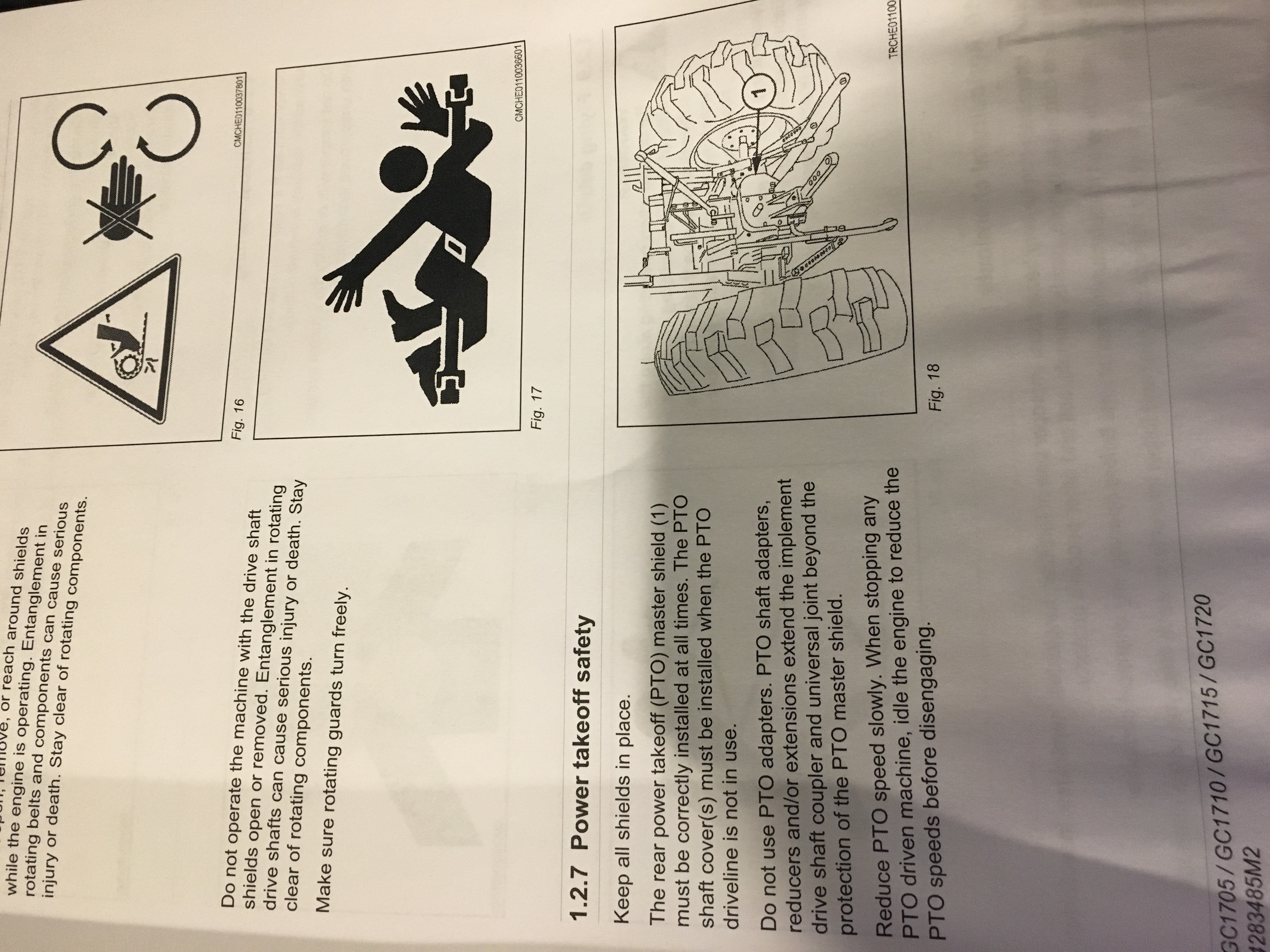

I took my backhoe off to mess around with the 3 point (I bought several things at auction this weekend). I noticed this guard (see pics) was in the way of the lift arms on the 3 point. I removed it. It also made it much easier to tuck my hydro lines for the hoe further away. While I was at it I removed the centerlink "holder" as I won't be using it much at all. IMG_2641.JPGIMG_2642.JPG

That is the PTO guard plate. It would only have been interfering with your lift arms if you didn't rotate it into the DOWN position. There is a bolt point for locking it in a tilt position when the backhoe is on and then you loosen the bolts (12mm) and rotate it down to a horizontal position when using the 3-point/PTO. There really is no substitute for reading the manual. I'm glad you didn't cause any damage, but the guard is to protect anything falling down on a spinning PTO shaft.

I actually referenced the manual. Here are all the pages on the 3 point operation....notice nothing about the shield or moving it.....alas I decided to re-read the "safety section" chapter 1....there is a small mention of a guard but not it's operation (last picture posted). Thanks for the info. I only have non/pto ground engagement equipment so I will be leaving the shield off as it really frees up room, especially for my top and tilt and 3rd operation lines I'm running....that's for a different post.
I guess for what it's worth did your manual actually say something about this shield operation?
