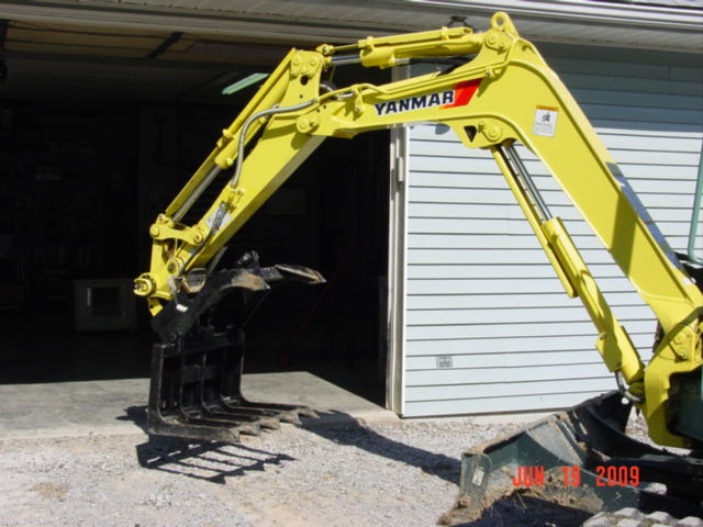

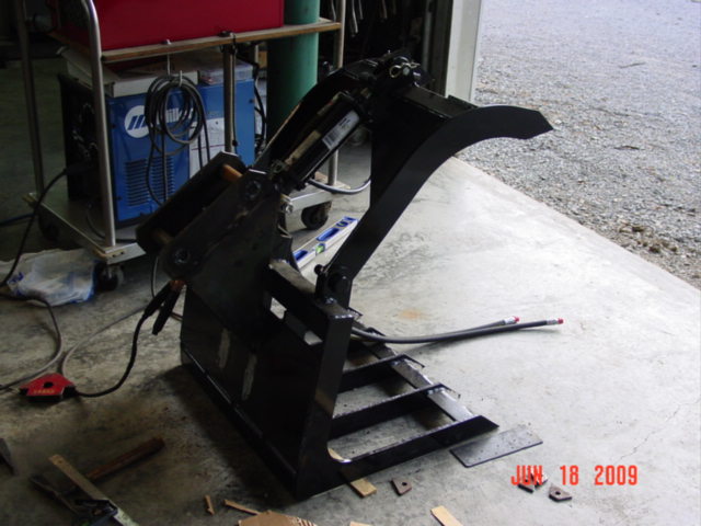

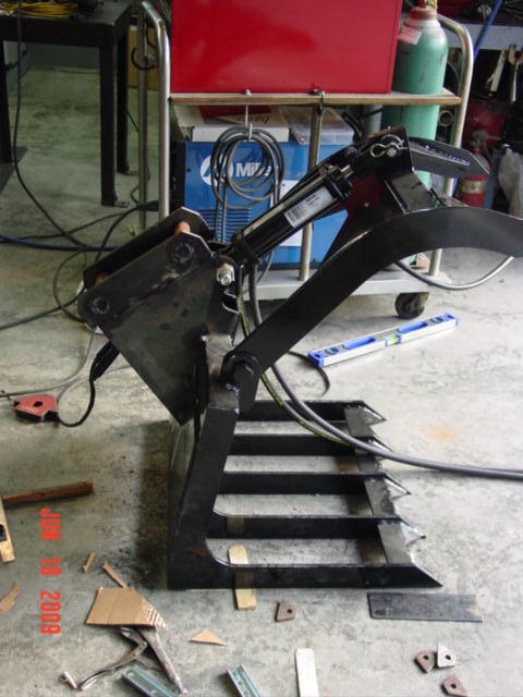

I purchased a grapple bucket for a miniskidsteer and adapted it to fit my Yanmar VIO27. The quick coupler on the Yanmar makes all the difference.

Kay's Supply, That is a sweet looking rig, is it about 3' wide?
