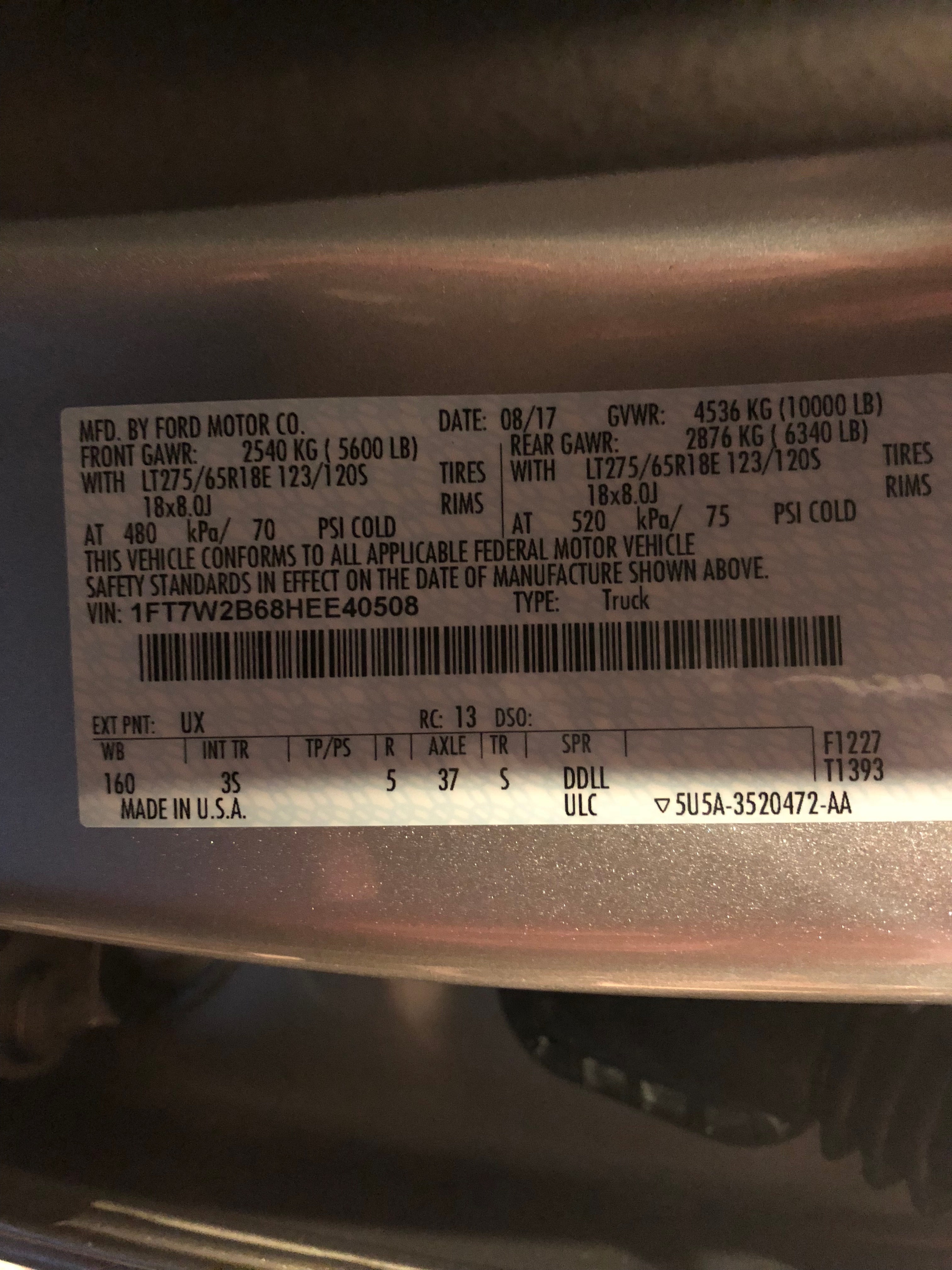

I could probably ask this question on a Ford truck forum I frequent, but I'm here now and there are many knowledgeable guys here and it's semi related to the original topic.
I've got a Weigh Safe hitch with built in scale. When hauling my 6500 lb. skid steer I have all kinds of room on a 14k tilt bed trailer so can move the weight wherever it needs to be. What's a good tongue weight to have with a 2017 F250 gasser? Here's the weight rating sticker:
   / Hauling mini excavator in a dump trailer? #9
From Weigh-safe - "Most experts agree – that an acceptable tongue weight for any trailer is somewhere between 9 to 15 percent of the gross trailer weight (GTW)." If you are towing a 9500 lbs trailer/skid steer combo, the tongue weight should be approximately 1000 lbs. I personally would be a shade heavier as on my Dodge it seems to handle the weight fine and smooth out the ride a bit. I am normally around 1200 on that weight trailer combo.
