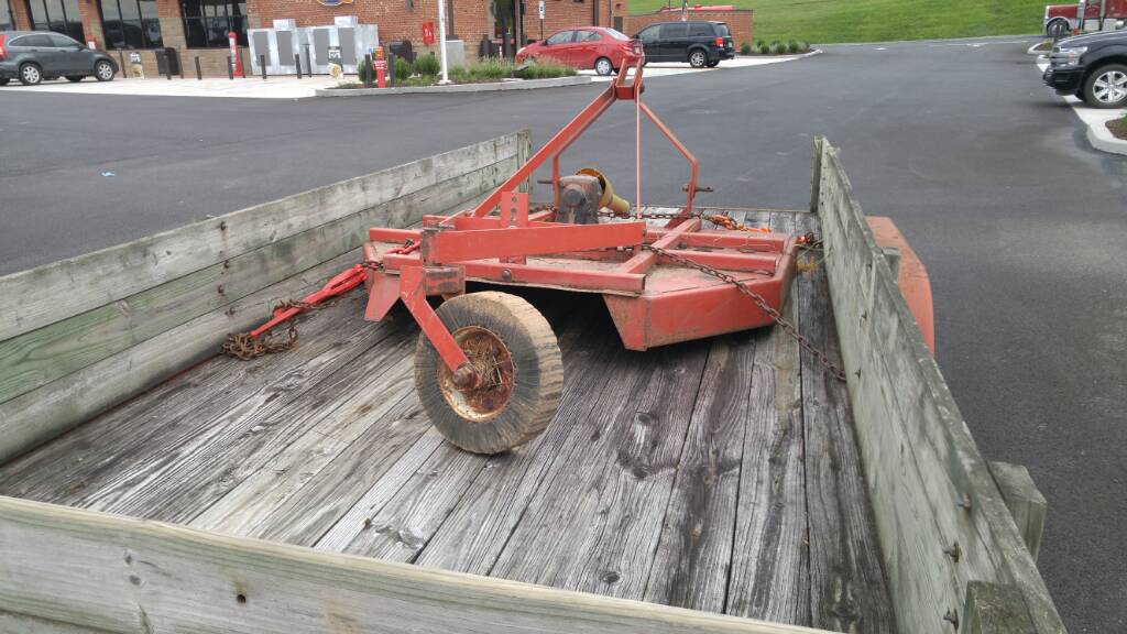

16 ft 5/4 pt deck boards bolted to 2x4s in stake pockets (assuming you have stake pockets). Mine are about 20 yrs old now.0922181228.jpeg

16 ft 5/4 pt deck boards bolted to 2x4s in stake pockets (assuming you have stake pockets). Mine are about 20 yrs old now.View attachment 573789
Same here 5/4 deck boards, except I have mine 4 high, works great and I can take the 15ft section off by myself, but it is heavy.20161118_095415.jpeg
