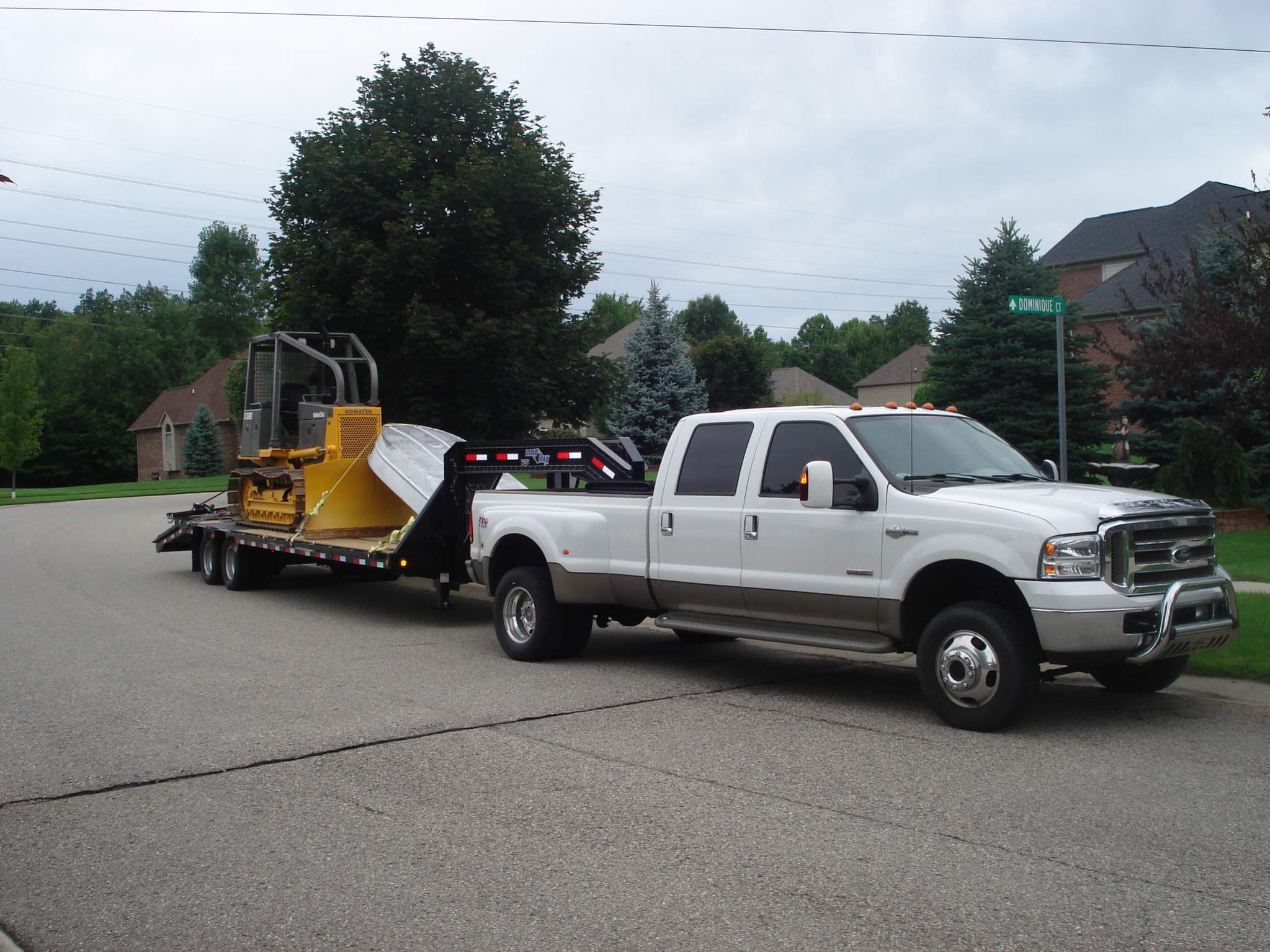

I have a 310C. Given a choice as you have, I chose a DRW. The truck's towing capacity is based on its pulling power. BUT...You will need a truck that can carry the hitch weight of a loaded trailer. Unless you can accurately load the backhoe on the trailer to keep the hitch weight from overloading the truck's rear axle... go with the dually. The dual wheels add a lot of stability while driving too.
   / hauling a 310c #7
I would also recommend a Dually, along with a 25+ 5 tandem dually gooseneck.
Works great for me!

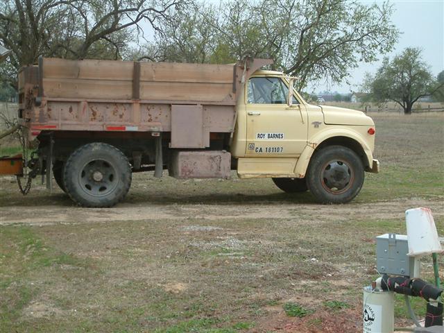

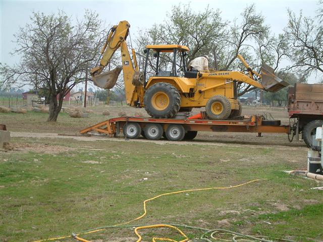

Just so happens one of my contractors has a 410C. He hauls it with this rig.
Looks like a relatively inexpensive setup to me. Of course, he stays off the interstates and travels the state/county highways most of the time.
