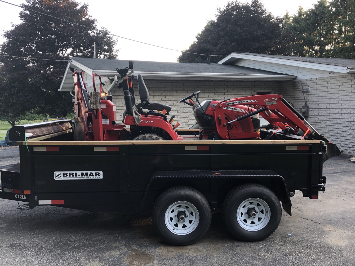

Bri-mar, 6x12, with a Massey GC1710. My gates could be pinned open.

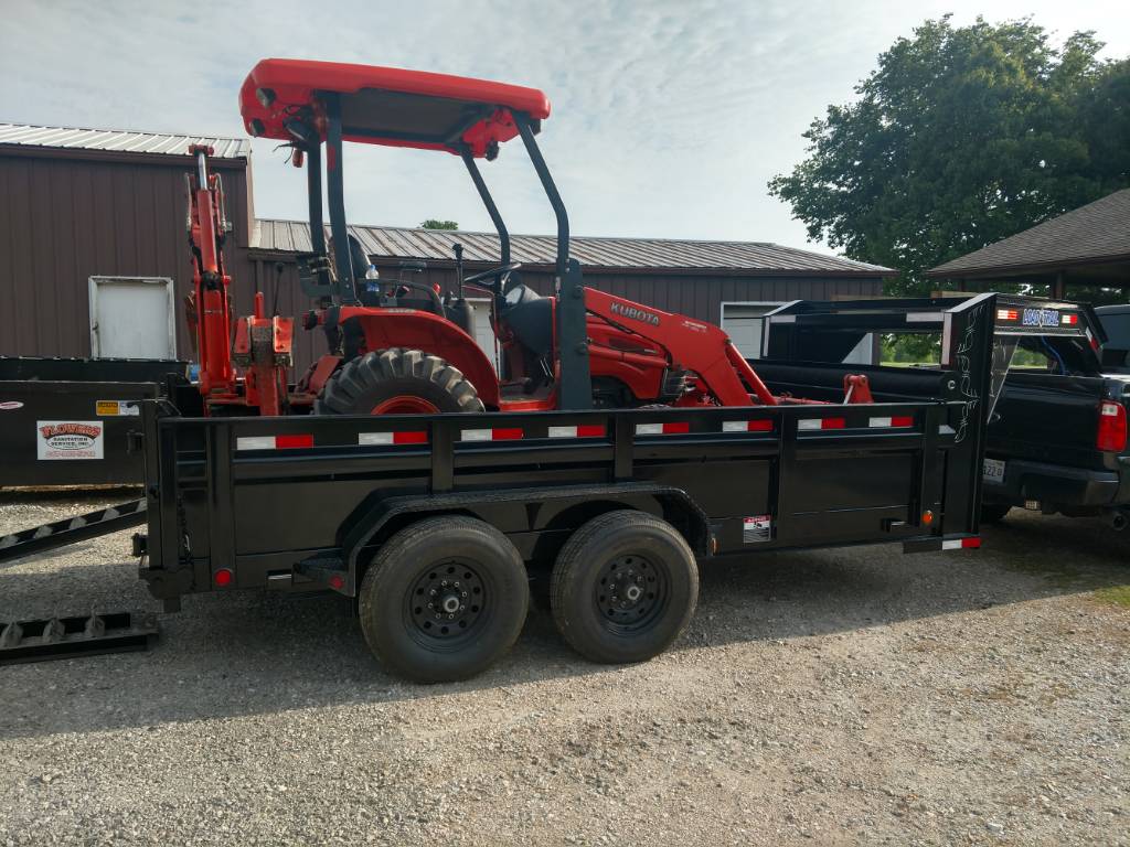

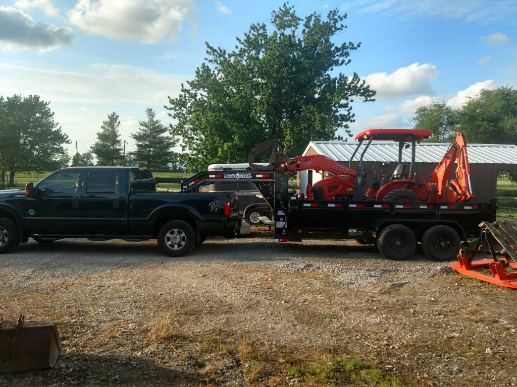

I have a b26tlb and can bring landplain or box blade and multiple buckets but have the loader on the neck. Trailer is a load trail 14' low profile 14,000.IMG_20180520_175017617_HDR.jpegIMG_20180520_184512177_HDR.jpeg

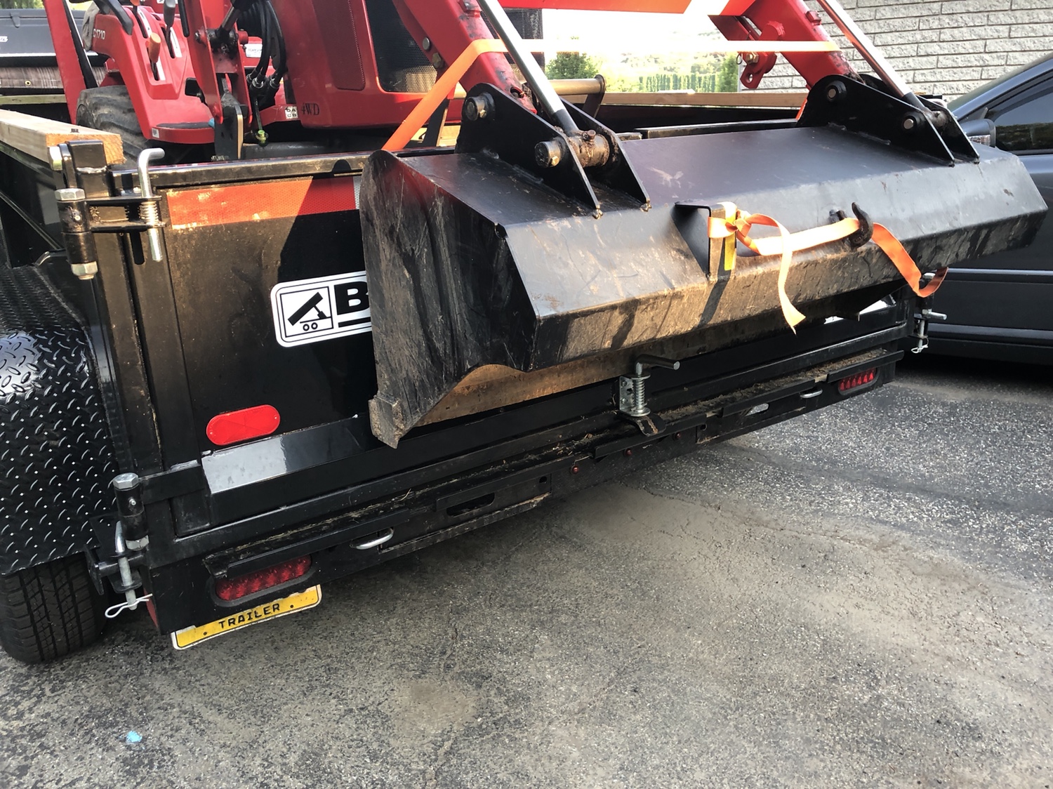

I've got a 6x12 CAM Superline. I can get my Bobcat S185 skid steer in, but just a couple of inches to spare on each side. Also, to have the weight centered over the axles to avoid excessive tongue weight I have to rest the bucket on top of the gate.
Steepness of ramps is also something to consider. My trailer has slide out ramps but they're not super long. Pretty steep and I have to back the machine on because of the rear being heavier. It would go over backward if I tried to drive on.
I didn't do it often, but I disliked it enough that I bought a 21' tilt bed for the machine & attachments.
