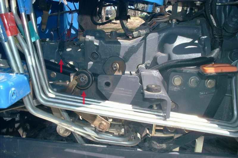

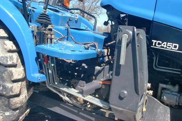

Kubotasrking, what a shame! Wolfpack2 has given you the link to my old thread which is the best advice I could give you. I do have more photos than I posted here on that thread, so if I can help you in any way, give me a PM or post here. There is already a hole in the platform over the running gear that you will see when you remove the rubber mat. To help remove the mat, I cut the mat on the side where the joystick is so I did not have to take the hydraulic lines loose. Once the cowling is reinstalled, you cannot see where I cut the mat. Here are a few pictures of the area. Two of them have the broken part removed so you can see how tight it is in there. I don't think you would want to be welding because the black plastic wire loom also has the fuel line running through it. I suppose with a wire welder, you might be able to weld in place, but I'm no expert.

Well I have her down to her skivvies now:cool:, it will just take a few more hours to remove the controls on the l & r sides. I saw that fuel line running through there, and couldn't help but think how miraculous it was for the last guy who welded on it that he didn't catch the fuel line on fire going both directions.
The part definitely has to come out to be cleaned up and rewelded...I guess it will be my next few days off project. Winter in the Pacific NW will keep it interesting...it is monsoon season.:laughing:
