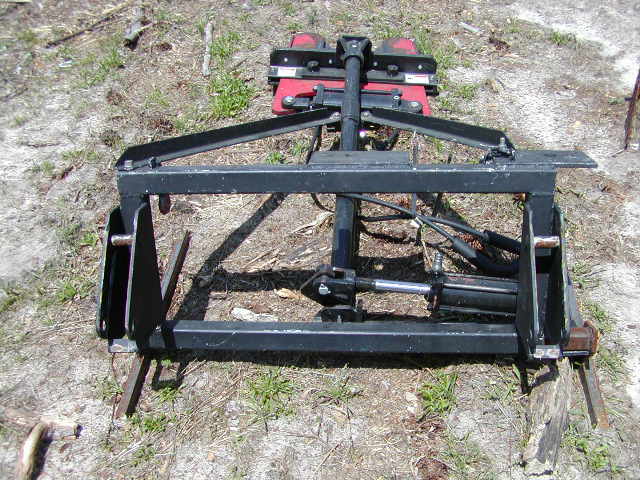

I have not used the tree terminator. I do have a high reach tree clipper from http://www.precisionmfg.com/
It will only cut up to 8" hardwood and may not cut as near the ground as the one you show. I think it will cut up higher, keep you farther away from the falling tree and will rotate to cut horizontal limbs off. I have used it a lot, and have a lot more to do. If you were to go this route, I don't think you want it mounted to the bucket which is one of their options. The stablizing chains they show, I replaced with angle iron. Will be much easier to use if you have hydrastatic transmission.
I bought the one to mount to the bottom of the bucket, then built my on quick connect mount for the loader. I think I have other pictures posted a good while back on tbn.
