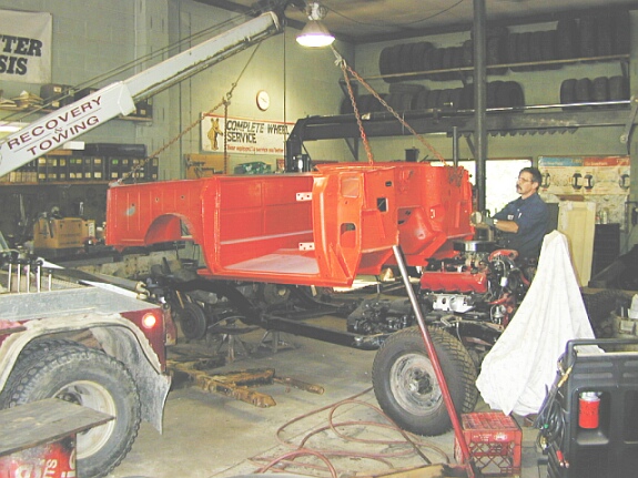

My father and I (mostly my father) are restoring a IHC ScoutII for a plow vehicle and have treated the underside of the truck frame and drivetrain components with por-15. The truck is a frame up restoration. It is not yet complete so it has not seen our very salty winters. I do know that the stuff is very hard when it dries, scratches pretty hard. I hope it (por-15) works well because we have spent a lot of money and time. From what I see there is a very important part of the process and that is the preping the surface using there metal ready spray stuff. We did this step even after sandblasting the metal. One note some of the products are UV sensitive and can not be top coated. But they do have stuff that works the same that can be topcaoted. Today we are trying the gas tank sealer kit they have. Well see how that works as well. From people that I have talked with that have had good to great results is that the followed por-15 directions very closely. I have a few picture I can post to show you, nothing too great.

See attachmnet.
That's pretty cool. Do a lot of people still drive them? My father has spent a lot of time and money to prevent it from rusting out. Well at least slow the process down. We know all about the drivetrain. We use the automatic for plowing. The Scout can get up and down driveway (for plowing) that our Ford Wrecker and new Chevy can't even touch! It also has the nice short wheel base and can almost turn on a dime.
