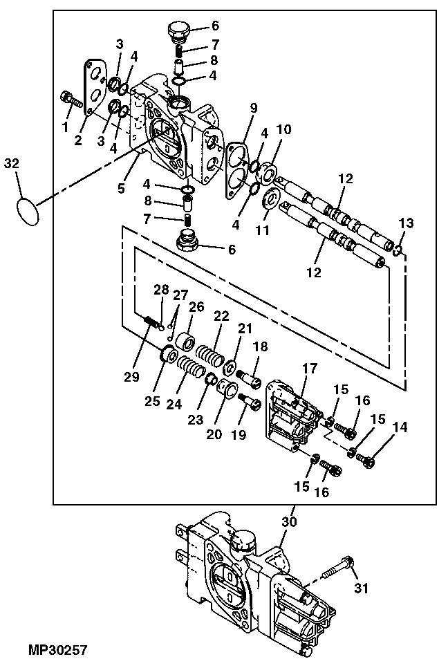

I know you guys are good at these things, so where is that adjustment on the 2210? I assume you take this cover off and adjust screws 18 and 19?
