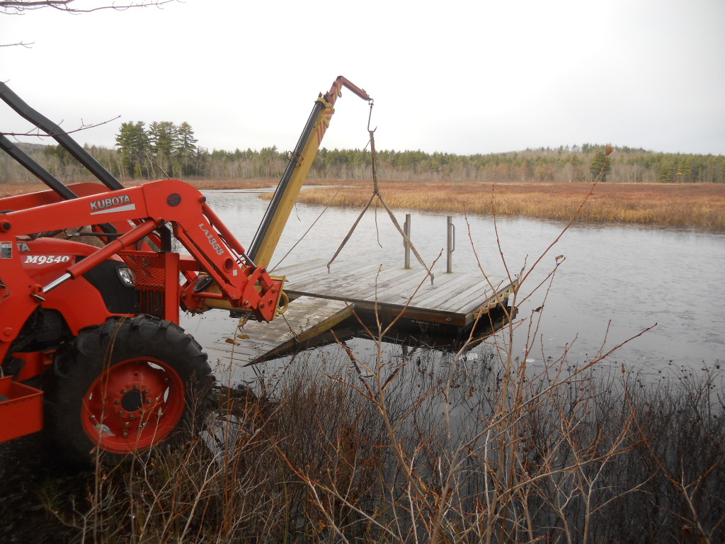

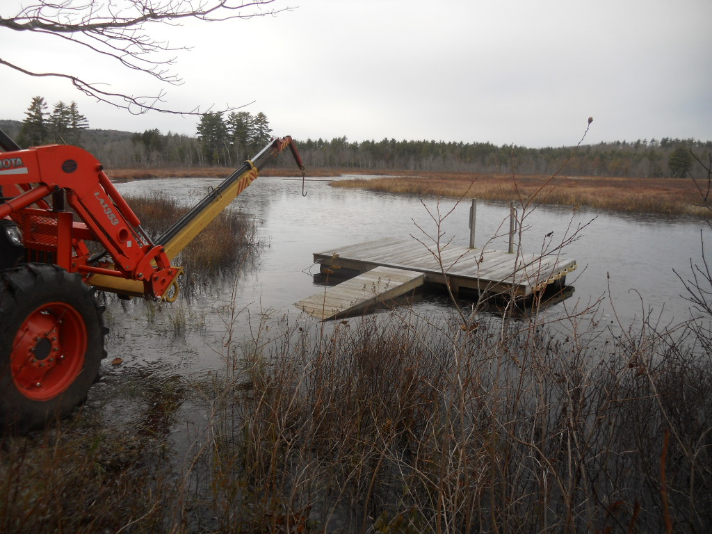

I built one out of some steel I happened to have on hand along with a cylinder.
The telescopic action helps with the initial lifting (boom flat - hook low) with your load is way out in front. Once your load is near vertical (close in) you can fall back to your loader/tractor rating. With trusses, you can stand them up by hand and then hook them. This one shoot's out about 9' with the drawn in length of about 12'.

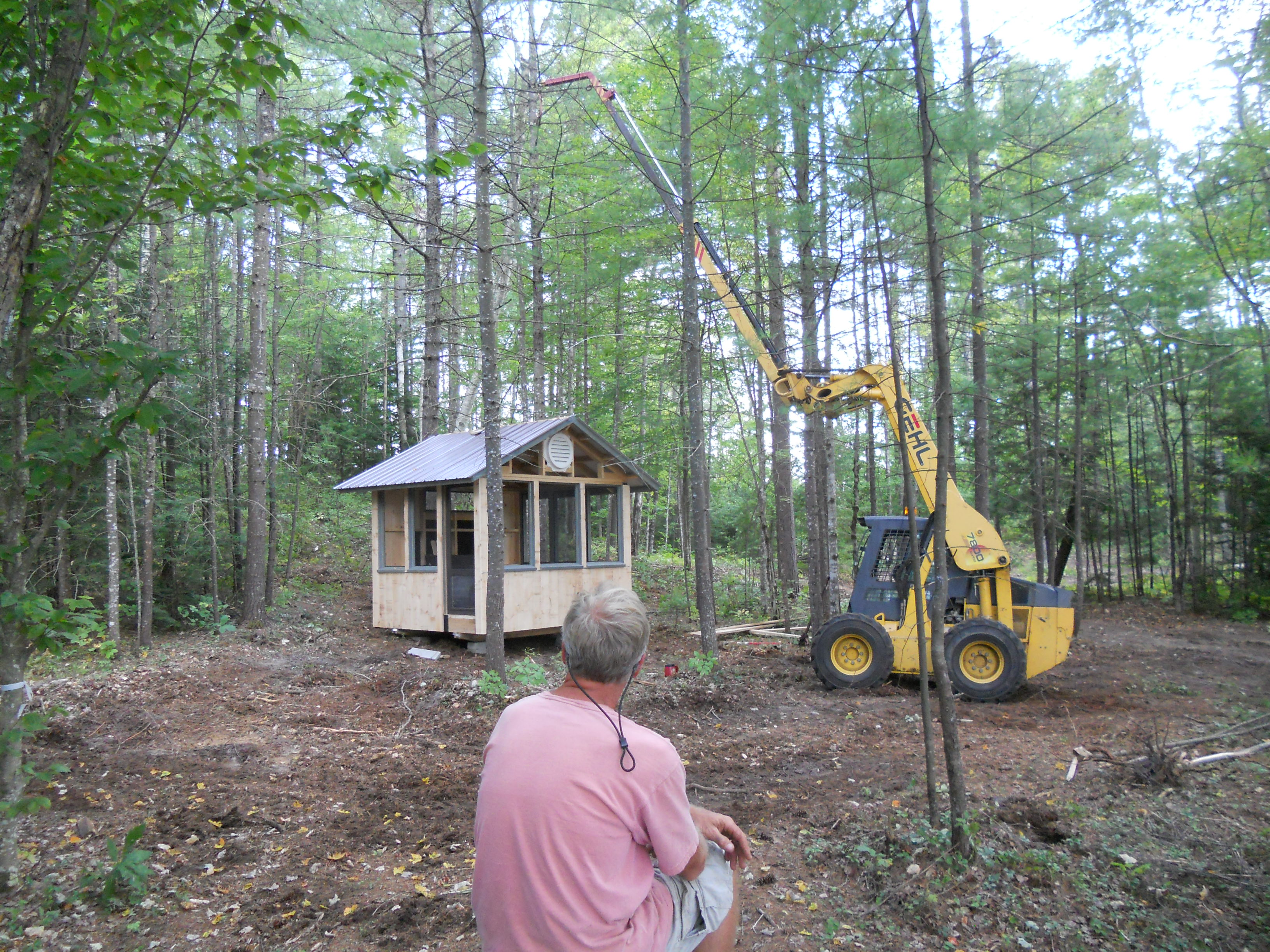

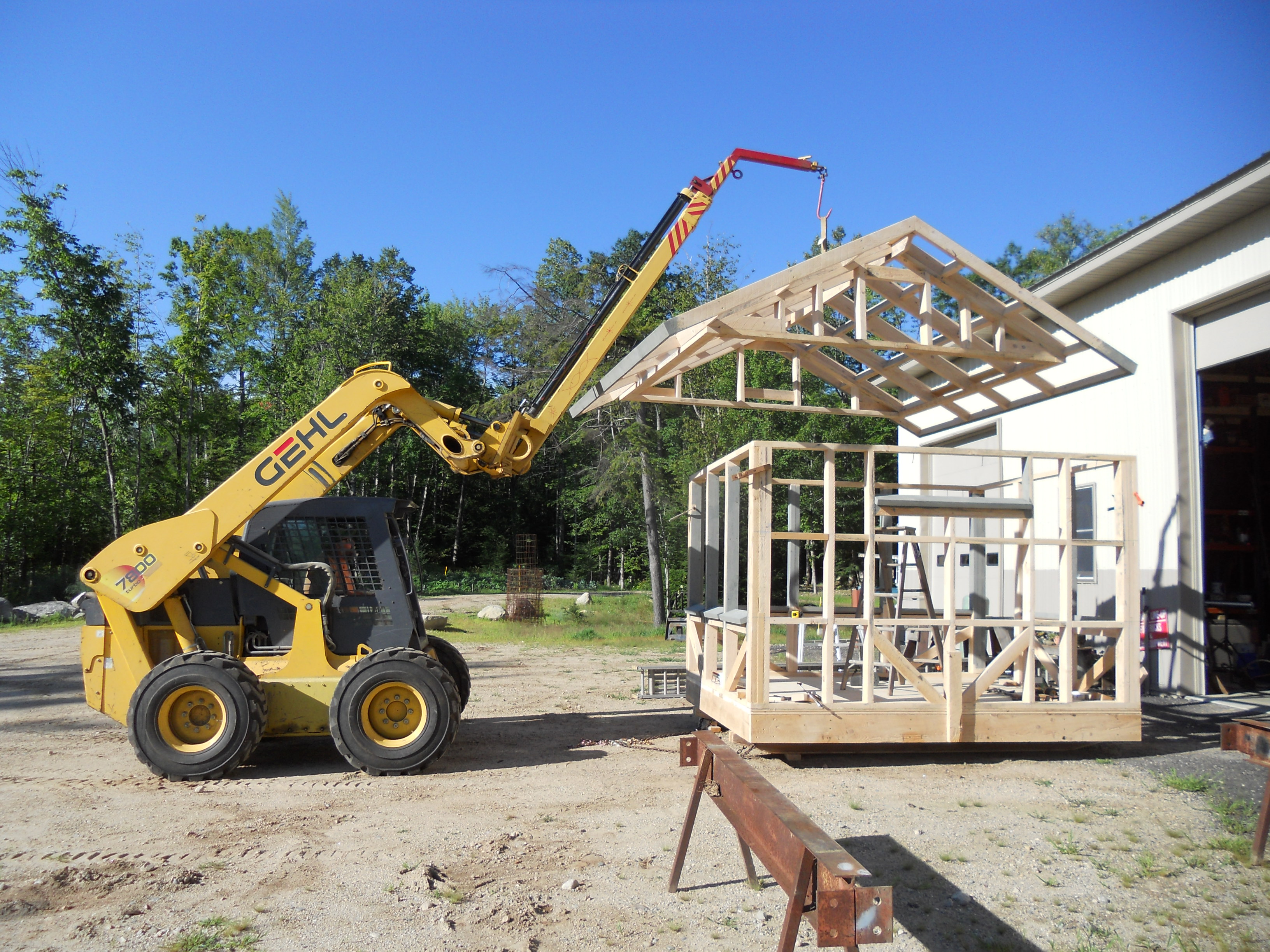

I prefer it on the SS with much stronger hydraulics. Here's a few more pics with one fully extended.
One of the little sleeping cabins I built up at the shop and trailered down to the camp. The roof was not attached for the move.
That's about a 28' hook height right there.

On top of the much stronger hydraulics my CTL lifts about 3 feet higher then my tractor.

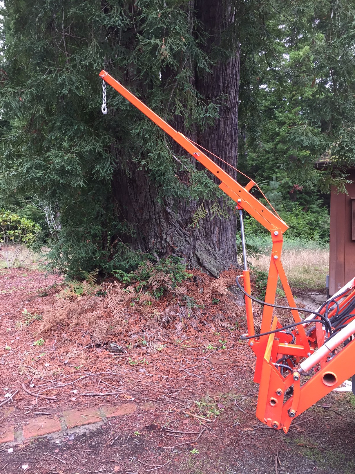

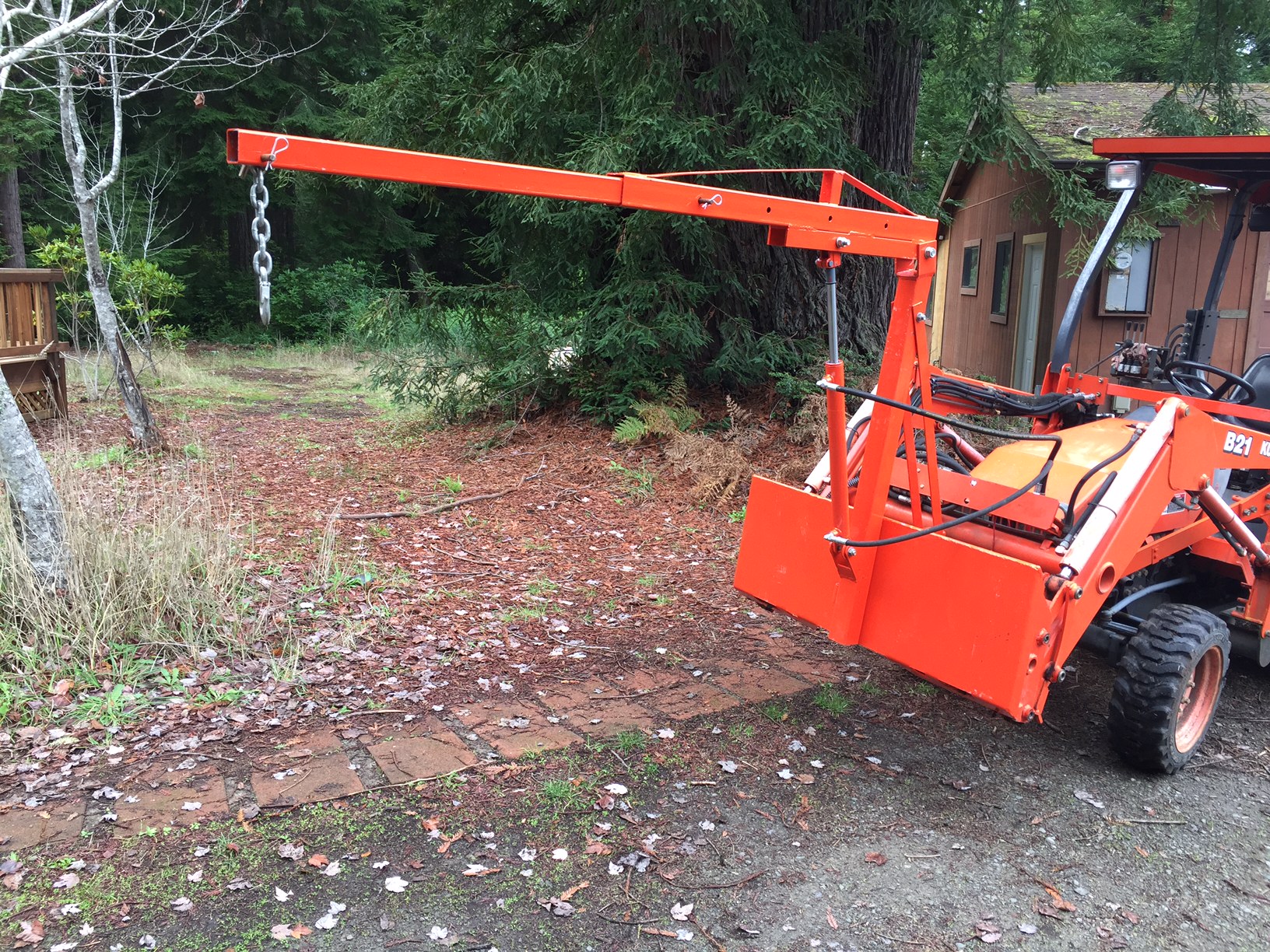

Here is a similar idea on a smaller scale with a smaller cylinder. With the boom fully extended, it can get up about 18 ft combining loader lift, hoist lift, and bucket curl. I will be using it to put trusses on a greenhouse later in the year. Have to be careful, it gets tippy. I use the backhoe stabilizers for more stability.
