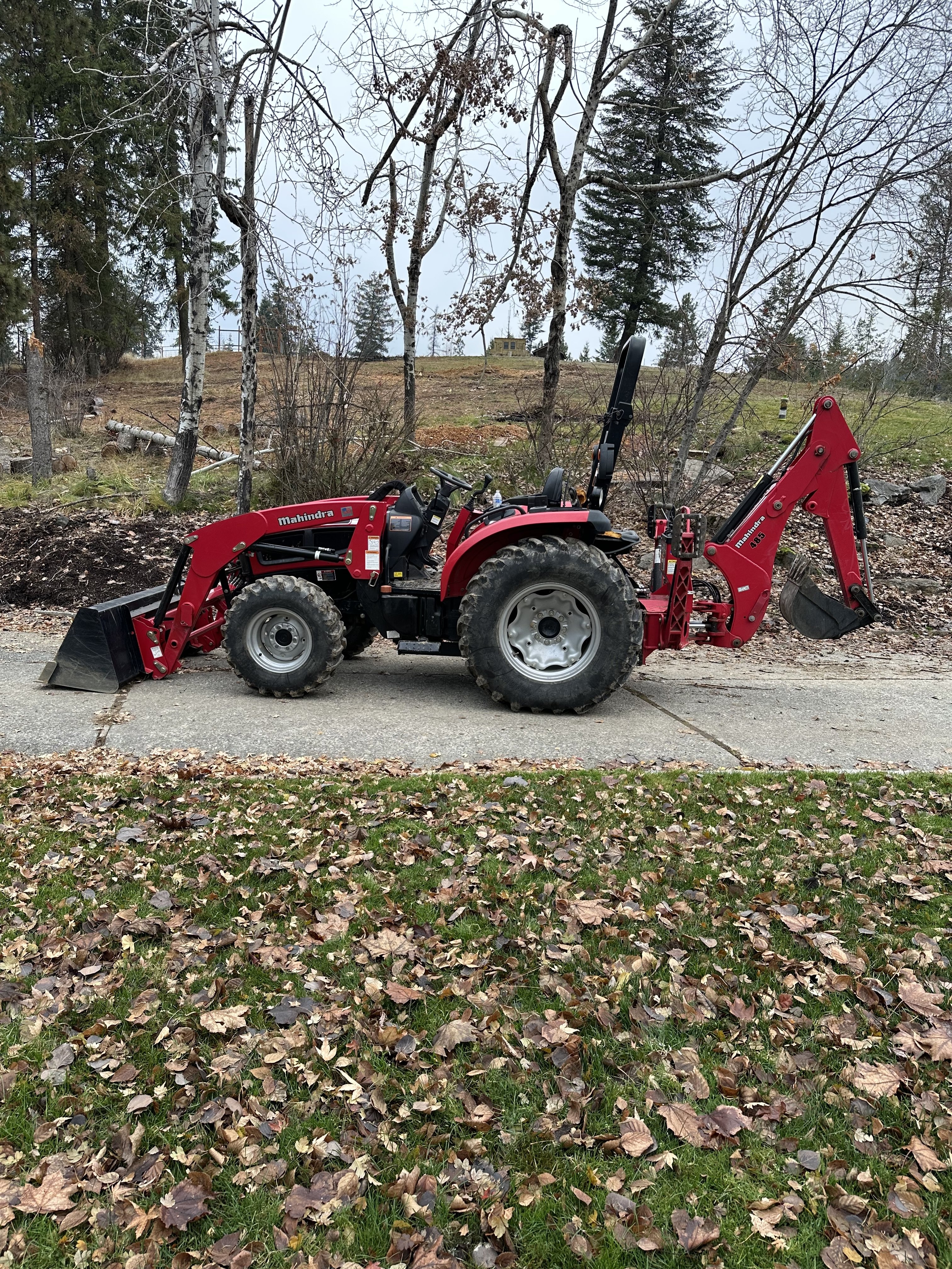

I want to add a grapple to my 4035. If anyone has installed a WR Long third function unit, any input would be greatly appreciated. If possible, any pics you could share would be helpful too!
Thanks much!

If you have a spare rear remote you can add a poorboy grapple control by using two 1/4 or 3/8 hydraulic lines ran up to front of frontend loader and use the rear remote control to open and close the grapple. I have used this set up on my LS XG3135 for over 7 years with no problem as i had duel remotes and a lot cheaper than a WRlong installation i also liked this setup as well as a the more expensive WRlong.
Another way to install a grapple control is by use a switching valve furnish by Tractorinnovations.com go watch their u tubs and the kit cost $625 i installed this kit on my Mahandra 2660 cab tractor and it does the job but i don't like it as well as the poorboy set up. The reason i dont like it as well as you can see in the tube you have to switch it back and forth to tilt the grapple and open and close the grapple. I was going to install a 2 nd setof rear remotes but they are expensive abd a bear to run the cables in the cab to control.

Thank you, Sir! I do have rear remotes and connecting to those is one of the options I've been strongly considering. From what I've seen online, it looks less complicated, and less expensive as you said. For my tractor, I'd have to extend and change the and angle of the lever that operates the rear remotes, so I don't have to reach back to access it. That's totally doable. Greatly appreciate you sharing your ideas!

Yes the control arm for my single remote that came with the 2660 (built by TYM w/ Mahindra Engine) is also too far to the rear for comfort using and no way to change. Instead of using the single remote for 3 point hydraulic cylinder to control my plows or tiller may end up using for grapple but will try the valve system first to decide

Makes sense. I’ll be curious to hear what you end up doing. I’m still noodling my options. Really appreciate your input.
Thank you Walter!
   / Has anyone installed a WR Long third function to Mahindra 4035 with backhoe? #6
Right now i am staying with Tractorinnovations it will do the job and the price is right for old tight wad and i dont use the graple very often also have a smaller tractor with grapple
