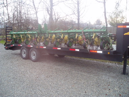

I want tobuild a cultivator. I have plenty of shanks/shoes and other stuff. How close to the plants do I want the shoes to go? I figure I need to figure ut the tire spacing on my tractor and go from there. Any ideas?

The shoes should be 4-6" away from each plant on either side.
If I were you, Id find an old cultivator owners manual and imitate the mfg recommendations.

The distance from each plant (row) depends on size of your crop, what it is, and how steady a' hand you have on the steering wheel.
Long straight rows of 3" tall corn, you can set the "sweeps" or "shovels" as close as a couple inches. It takes tremendous concentration to NOT plow out your corn crop though. Most people are better off staying 4" to 6" away.
Old cultivators are a dime a dozen (at auctions or implement dealers) It's a piece of cake to cut down a 4,6, 8, ect... row unit to make a 2 row model. Then you have extra parts for the NEXT project too.

Here's what you start with.....
