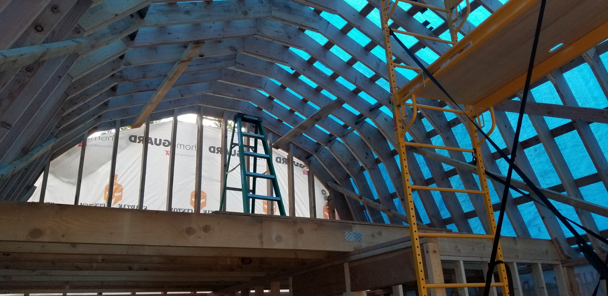

The rafters look like they only have a 4in tie plate. Theres really nothing keeping a side wind from blowing tje thing sideways becids the end walls.
This is overkill for a shed but i recently built 20' wide gambrel trusses for a cabin. Rafters are 2x10 and plywood is 28in wide.
