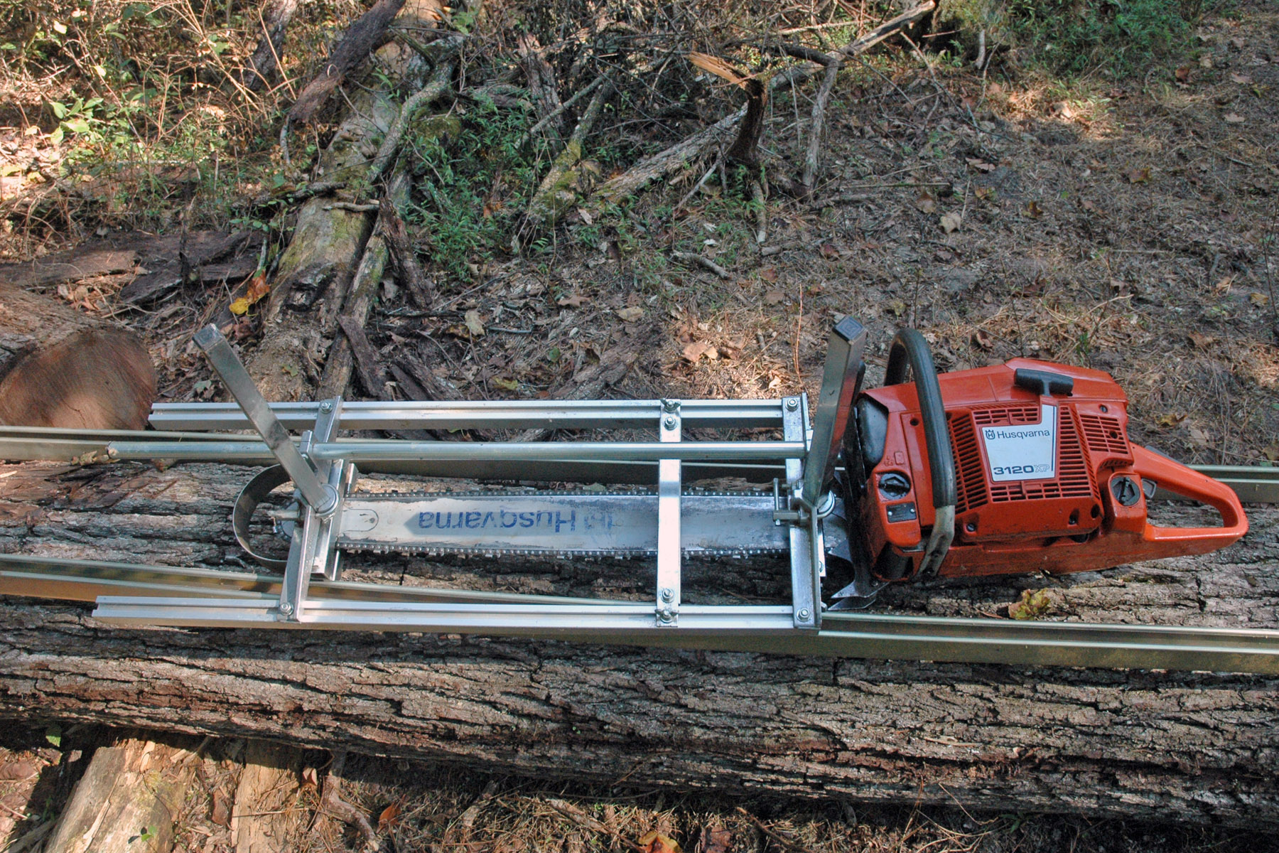

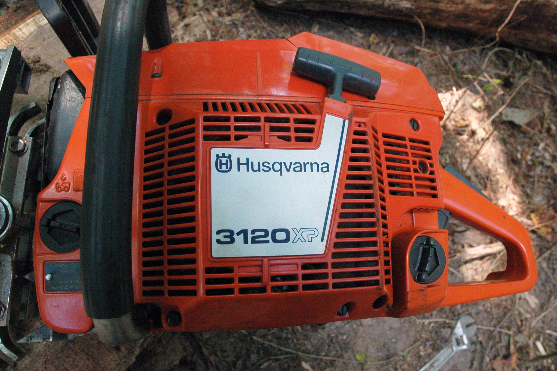

The Alaskan Saw Mill is a rectangular frame that clamps to the bar of a chain saw. I use a Husqvarna 3120 XP power head with a 32" bar and a rip chain. The saw has plenty of power (8.4 hp) and a trigger lock--two features which are important for portable saw mill use.

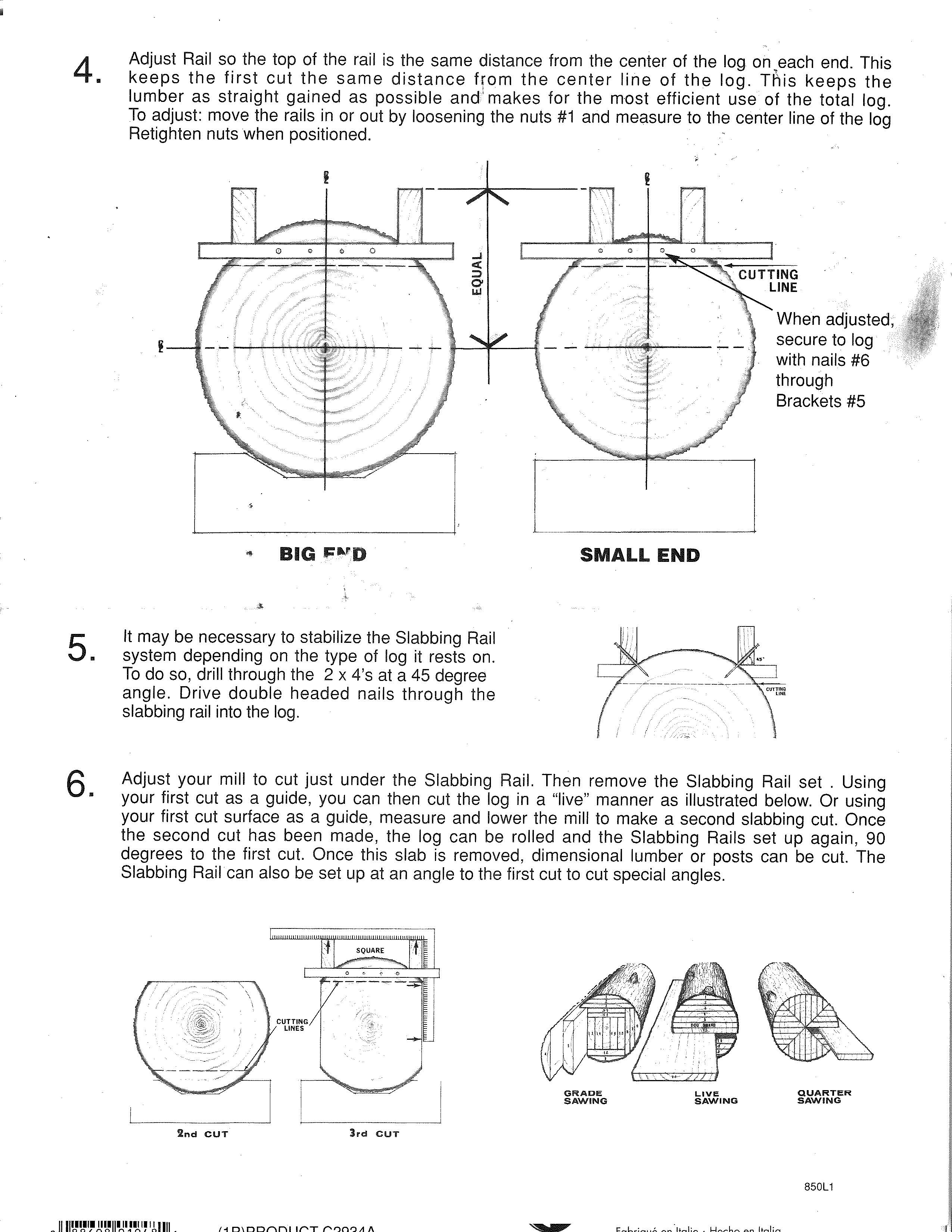

I also use the Alaskan Saw Mill G 850 slabbing rail brackets for the first cut of a log. Instead of using 2 x 4's for rails as suggested in the instructions, I use a pair of 10' perforated steel UniStrut channels. They seem to be straighter and stiffer than 2 x 4's and don't tend to get cut up for other purposes and be unavailable when needed for slabbing.

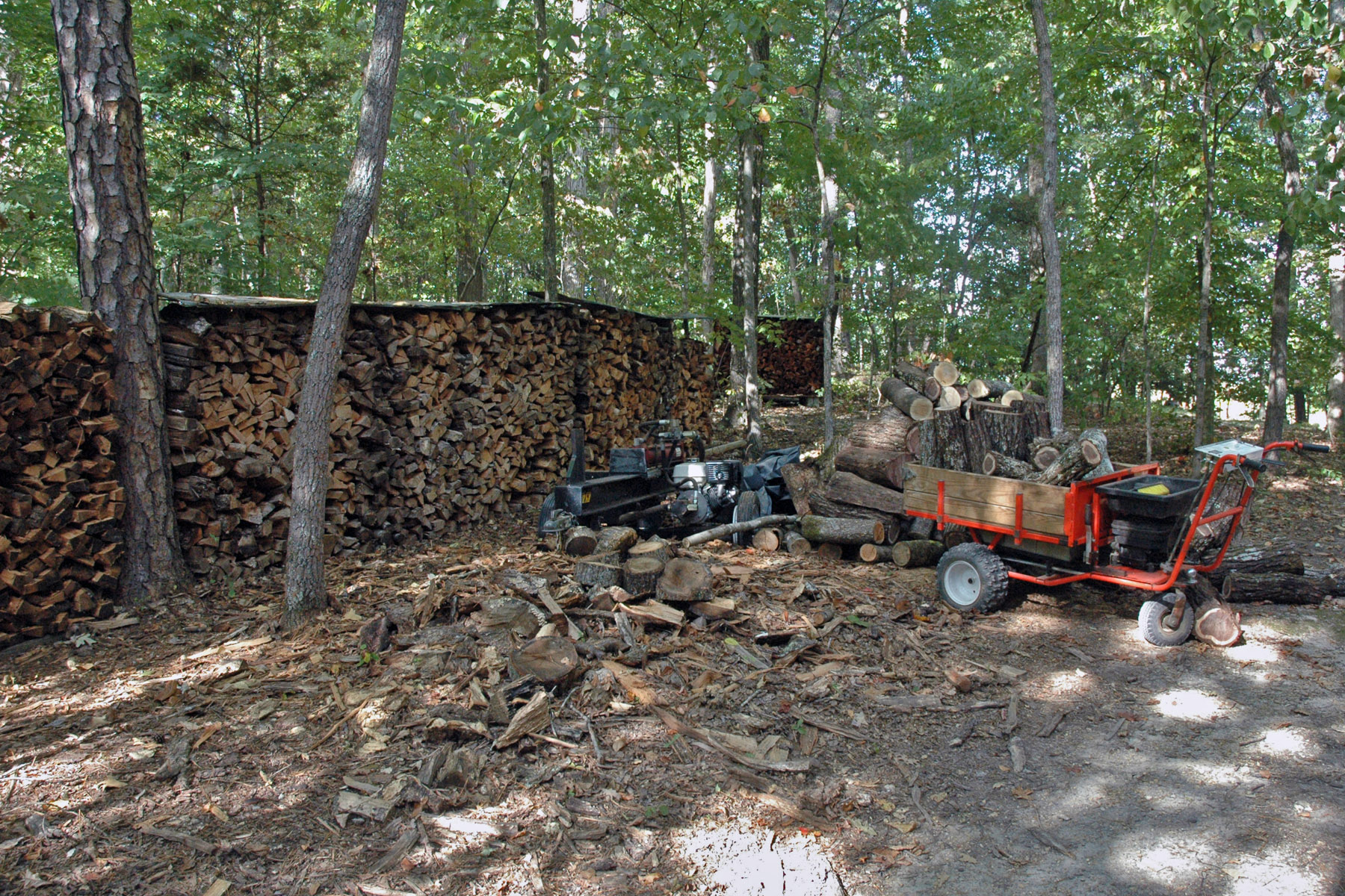

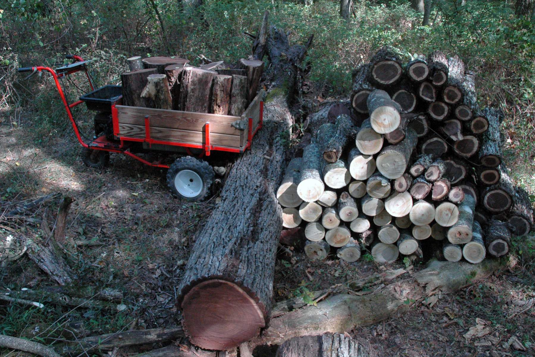

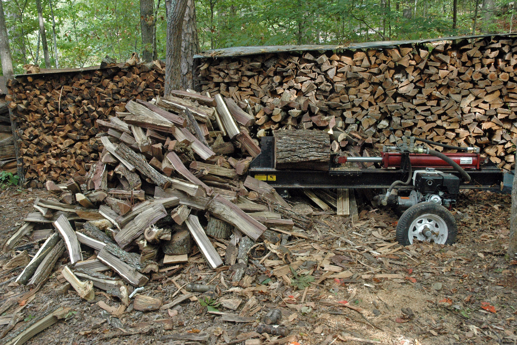

Before slab cutting (or live sawing) the logs, I limbed the tree and cut the top and branches in 22" lengths for firewood. Other trees that were in the fall line of the walnut were also cut into fire wood. My "orange tractor" (the 5.5 hp DR Power Wagon--it's all I've got :eek:) was convenient to bring the fire wood up the hill to the house for splitting. I may be one of only a few TBN members whose chain saw can out power his/her tractor.

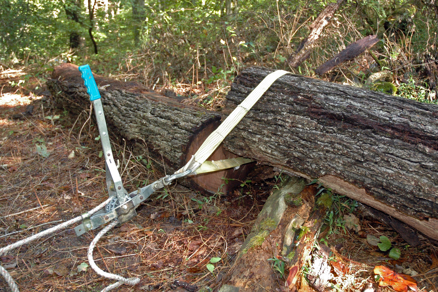

Next, two logs 9' 6" long were cut from the trunk, and the lower log was pulled into a convenient position for slabbing with my log winch/skidder (human powered at about 0.25 hp :sweatdrop:). Although this setup lacks a LogChain (my moniker), it's light and effective.

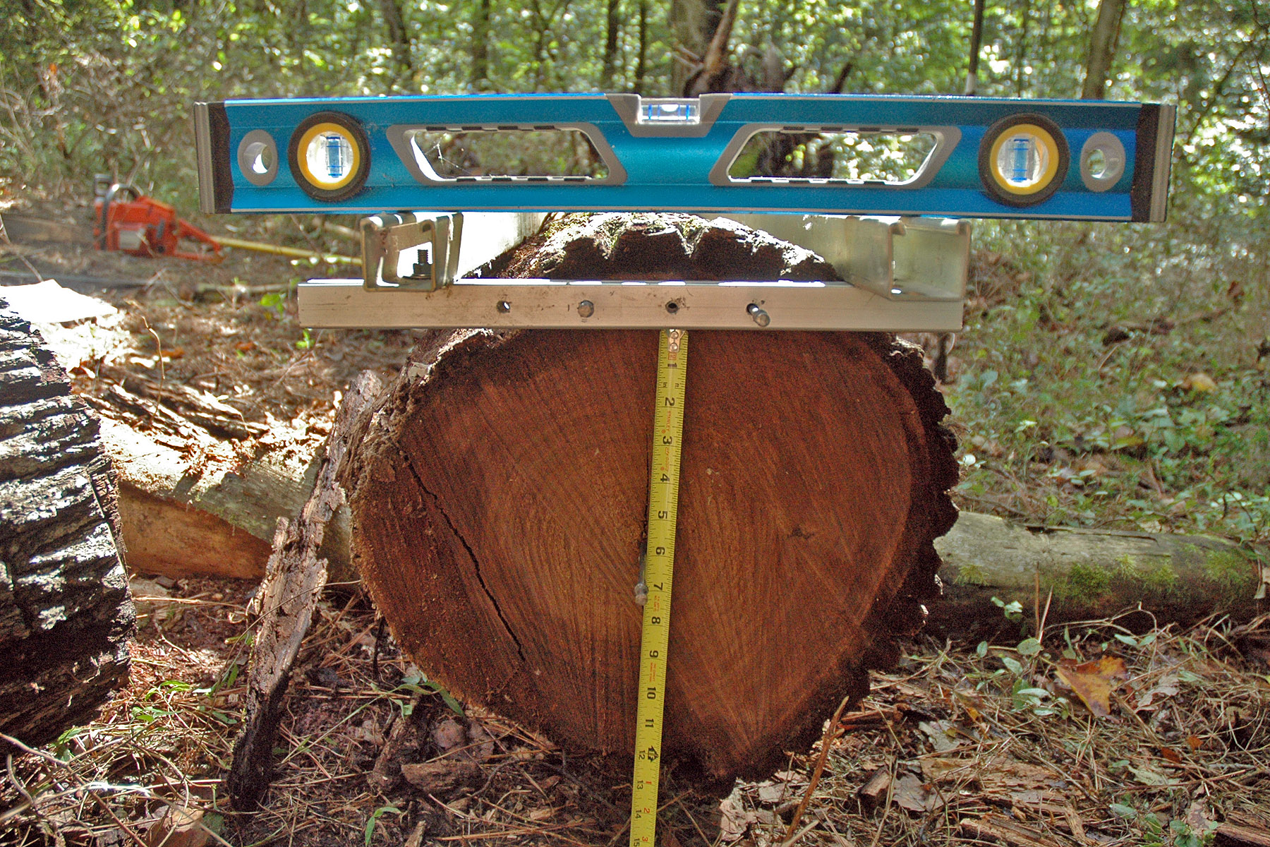

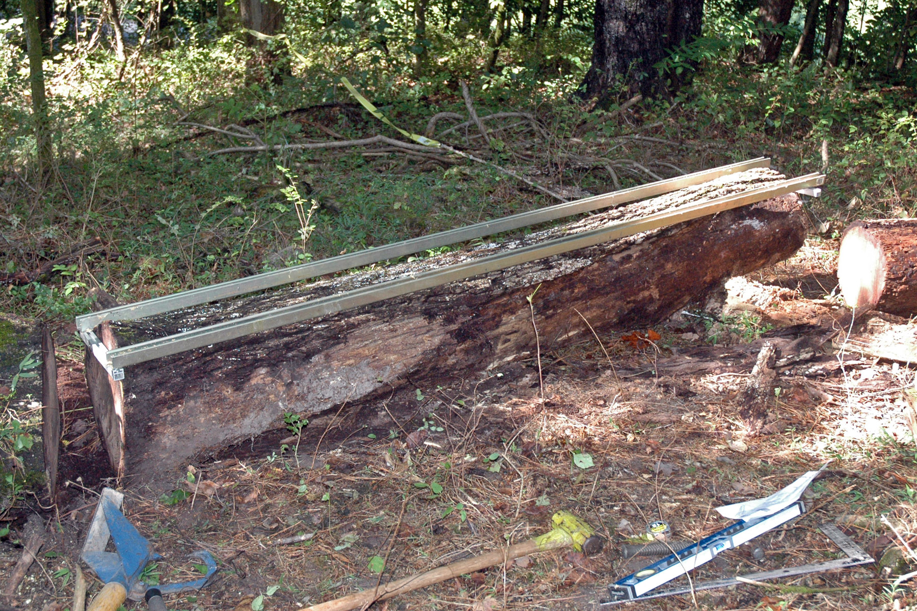

Then the two rail brackets were leveled and attached at opposite ends of the log equidistant from the log center (in this case ~6.5") with four duplex-head 20p nails. The two 10' UniStrut rails were finally placed on the brackets roughly parallel to each other and secured with nuts.

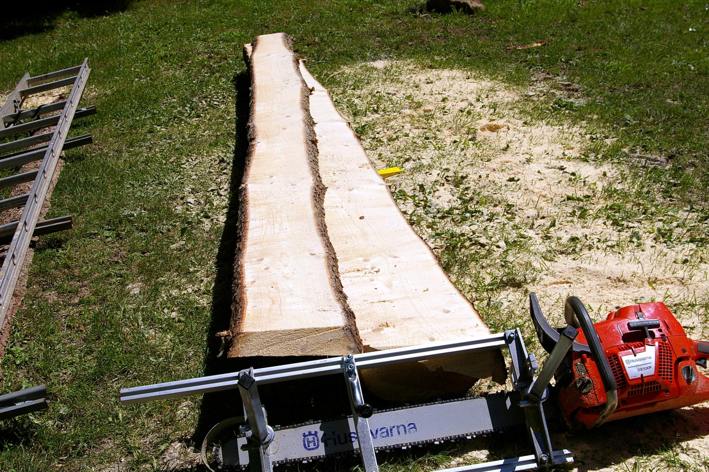

Using a sawmill is a lot of work. I use mine every now and then. Here are some slabs I made benches out of. That is some nice looking black walnut he is sawing...
