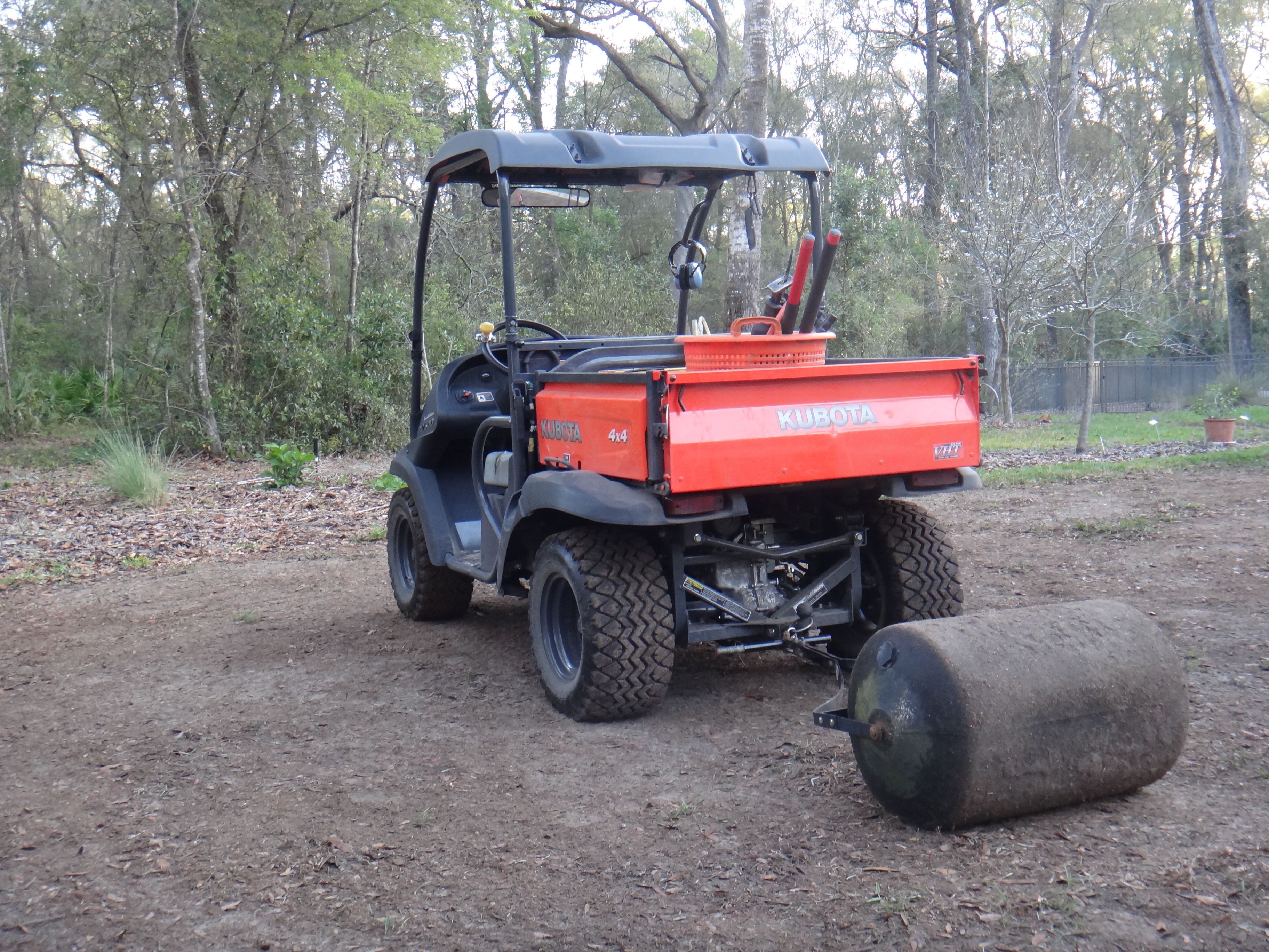

All mat harrows have three degrees of aggressiveness, depending on how they are oriented.
Rolling in fine seed will give superior germination over covering fine seed with a harrow. A cultipacker is optimal for rolling in small seed but an inexpensive poly roller is satisfactory.
