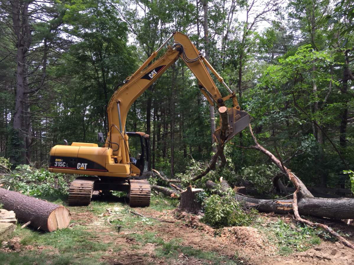

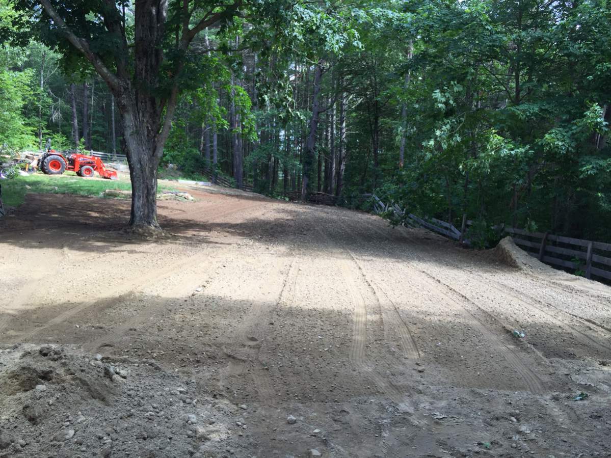

Here is a before and after of a small area cleared, then ready for seed.

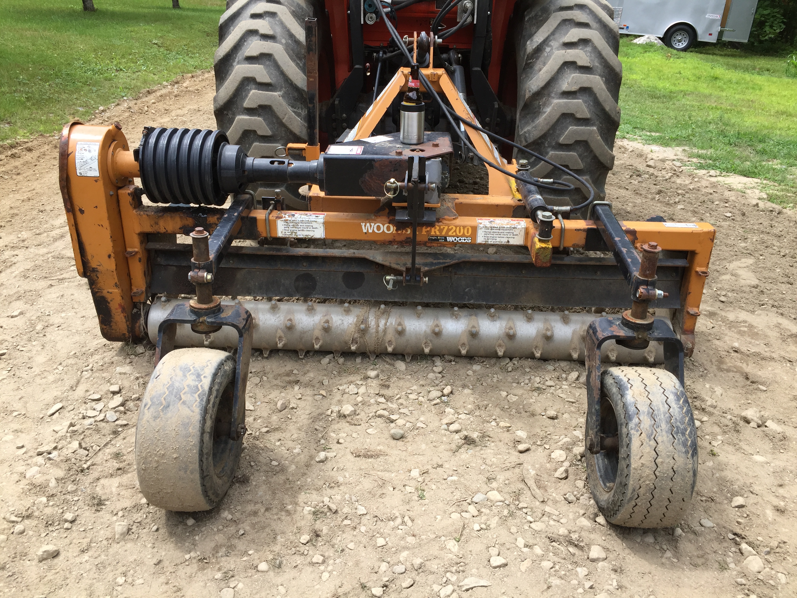

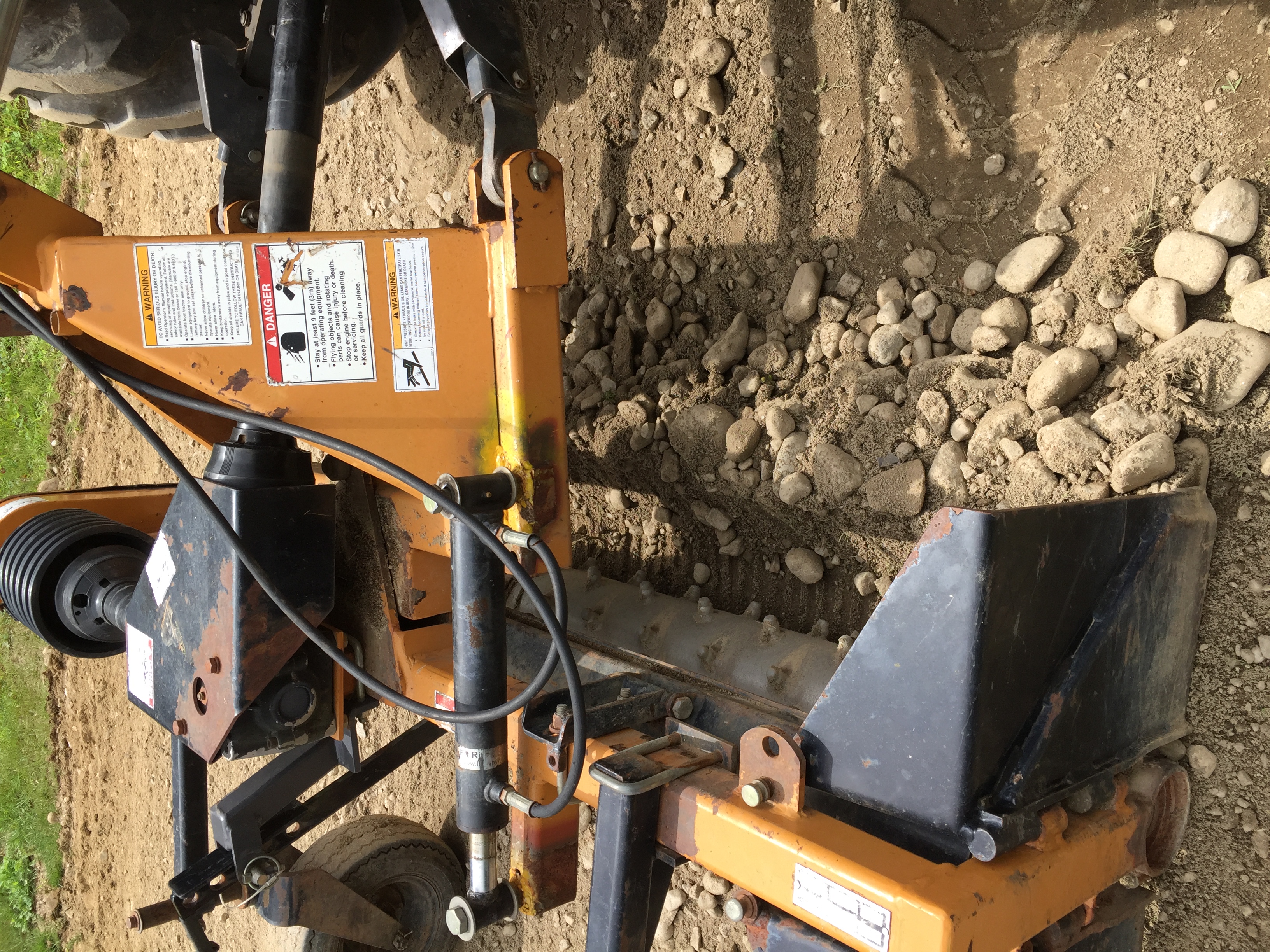

And some more close up photos of the the unit. The power rake can be adjusted so large debris can fit through it, or only minimal debris, depending on what you want to accomplish.
