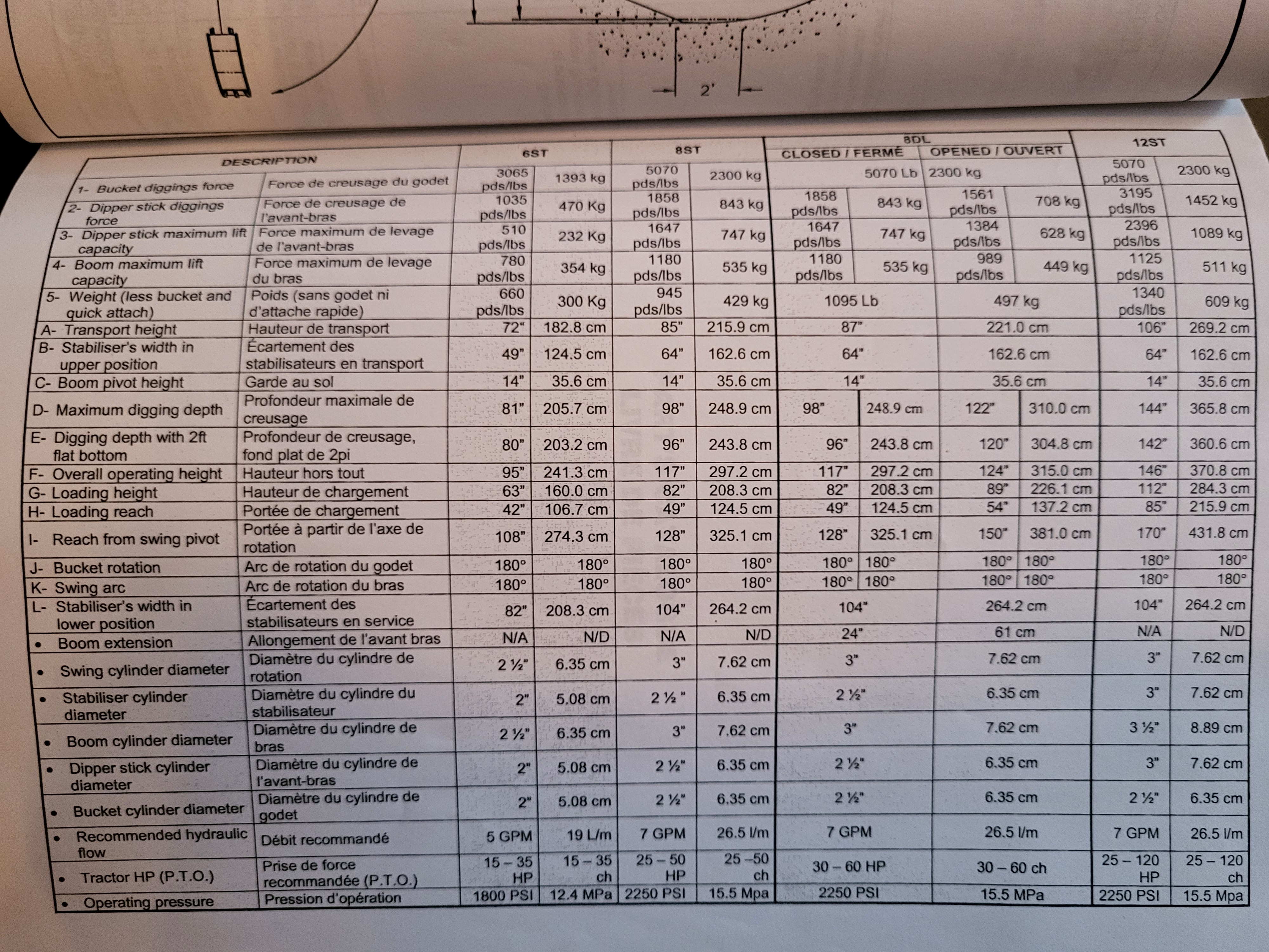

Looking at buying a Hardy 12ST so would also be interested in the manuals for them, but even just the specs would be helpful at this point. Thanks.
   / Hardy backhoe manuals #5
Found this, in case anyone was looking for specs on the Hardy backhoes.

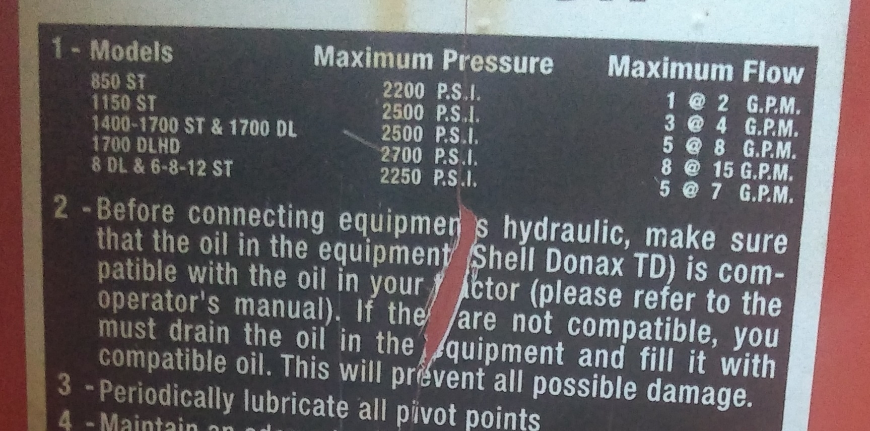

   / Hardy backhoe manuals #6
Picture of the sticker on the side of a Hardy hoe with maximum pressures and flow by model.
