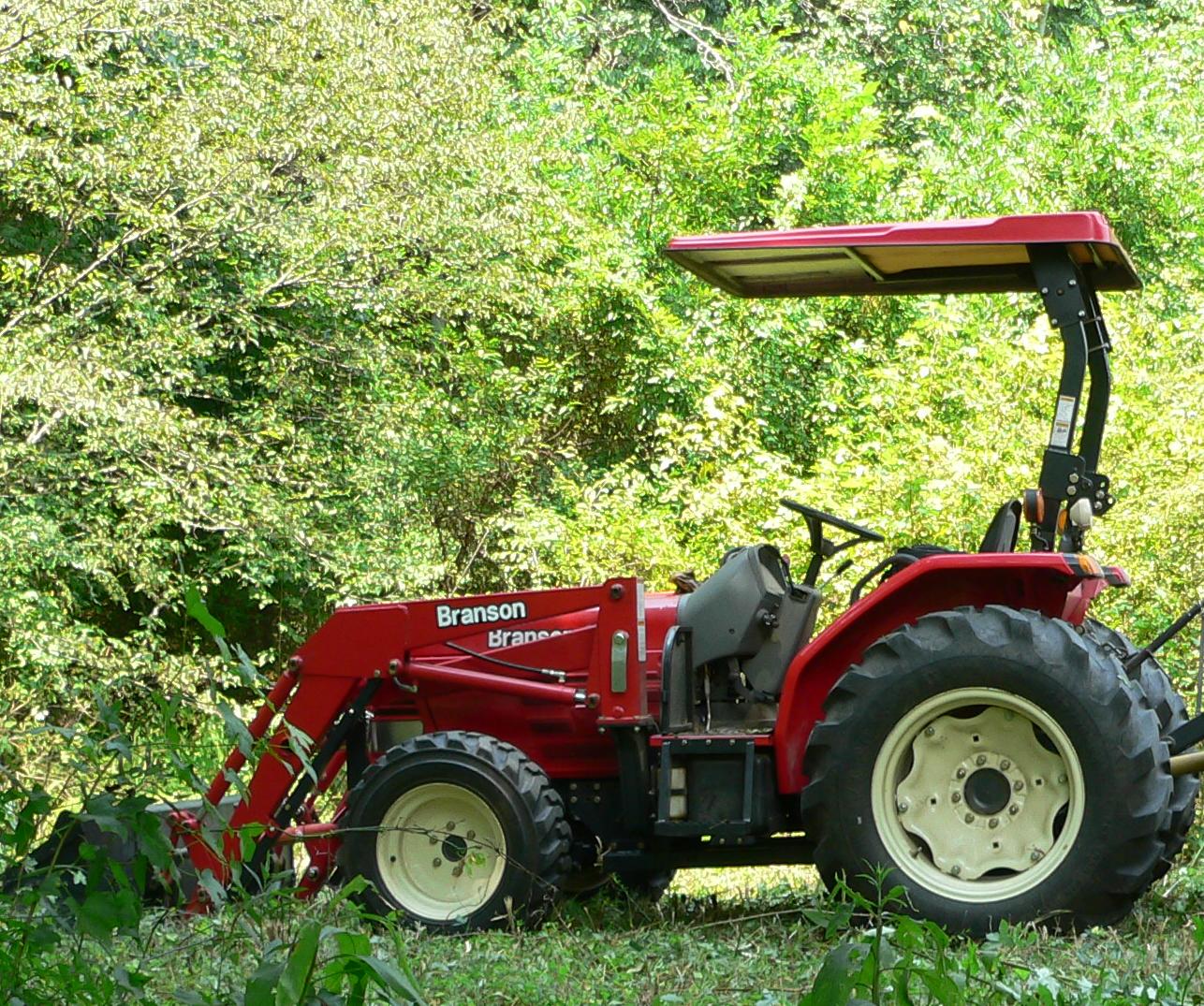

I had an umbrella for my rig, and that was an improvement in summer comfort over no sunshade. Now I have a FEMCO canopy and it makes mid-summer heat tolerable. The FEMCO is a good unit and I found them pleasant to deal with when I ordered mine from them.
As for sound levels increasing with the canopy; without a sound meter to give definitive data, my subjective feeling is there was no increase in noise.
The only real noise was a mild banging when going over bumps and that was due to the amount of cantilever in all canopy designs. Once I put front posts on my canopy, the banging and vibration went away and it's much nicer.

Whatever canopy you buy (or make) make sure it has sound suppression material - especially if it is of metal top construction. I made my own top from an aircraft structural panel (1/2" honeycomb aluminum) and the additional noise (reflected) was staggering until I added a 1 1/2" compressed fiberglass insulation board under it. I had see this on some tops before, and wasn't sure why they had it until I tried it bare. I would assume plastic tops are less reflective of the engine sound, but may also be an issue..
